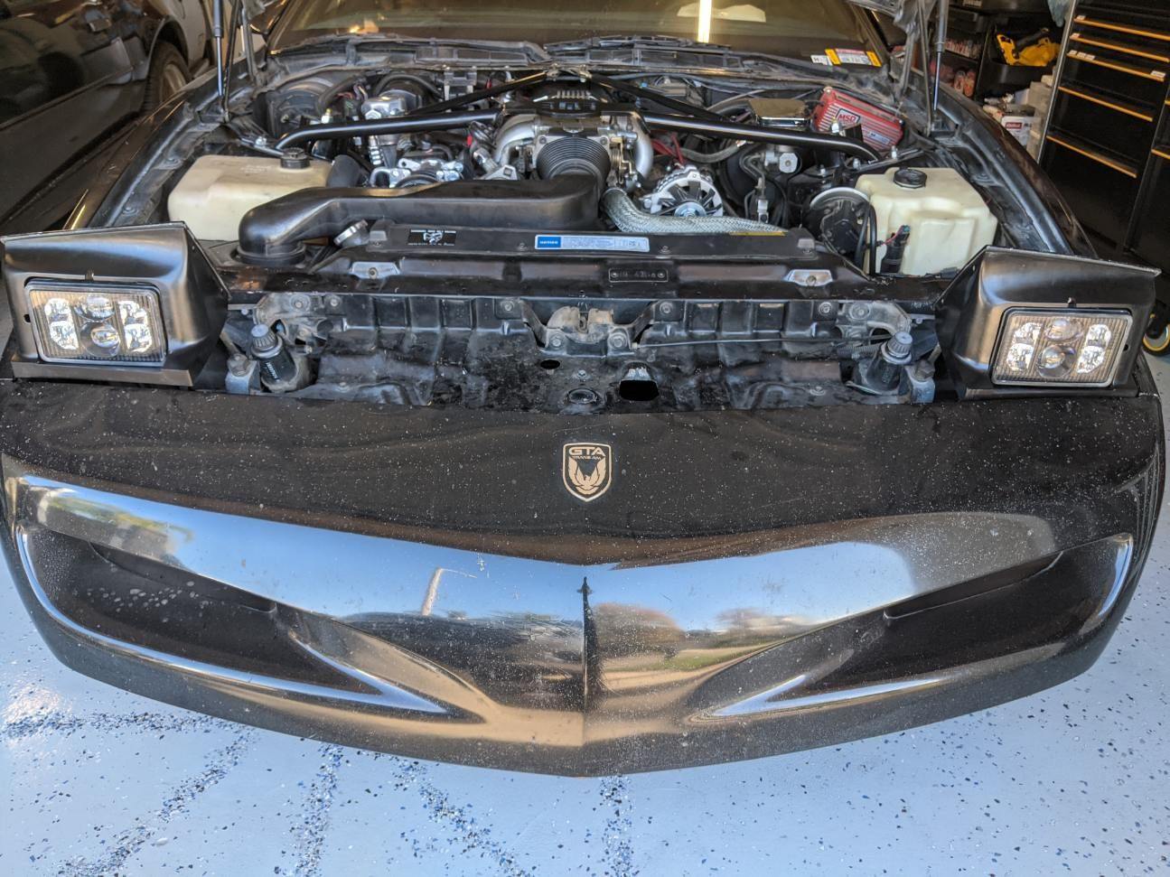

I stopped being retarded and figured out a much cheaper, and better, solution. Just got a couple of H4 connector pigtails from my local Autozone. Removed the pins from it, and did the same to the stock connectors. Then put the stock wires into the new connector and everything plugged right up. For quick reference for those doing it this way in the future, the wires are as such:
Stock:
Black=ground
brown/tan=low beams
green=high beams
On the Morimoto LEDs:
black=ground
blue=low beams
red=high beams
Once the plug situation is resolved, installing these isn't any different than swapping in stock replacement bulbs. Overall a VERY easy process. Super stoked with how they look. I even stood there for a solid fifteen minutes just admiring how they look. Oh yeah, you guys want to see them installed. Here you go:
I'll get some photos of them on at night in the next couple of days. Until then, feel free to hit me up with any questions.

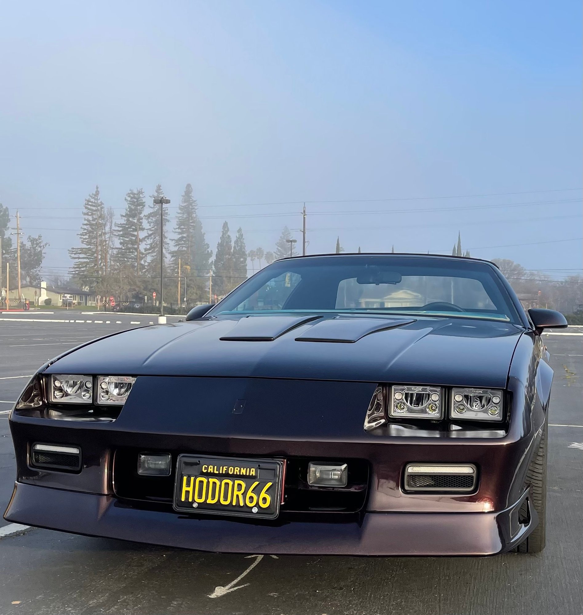

So i got a picture of the lights on and the low beams , I am amazed at the wide coverage these VisionX gave me compared to my h4 bulbs
so this is what the low beams look like . Last time i thought the high beams were the low beams

Not the full nighttime comparison, but I was able to turn the lights on of both cars in the garage. Even without seeing down the street, you can see the difference in brightness and color.
With the reference point being only 2 feet in front of the car, that's pretty good. The beam pattern looks sharp, almost twice as wide as the sealed beams, and about twice as deep, too. And, what, 5x brighter? Out on the road they should make a big difference. Thanks for the pic. Hope to see more when you get it outdoors.
There you go. Bright too. I like the halo headlights on Camaros. Thanks for the pic. Love to see more when you get a chance.

That'd be awesome. Yes, my plugs are now H4 (both female and male). Was able to snap a couple of photos during my drive in to work this morning.
Low beams
High beams
Old Dec 10, 2020 | 05:52 PM

Re: FINALLY! DOT, LED Headlight For 91-92 Firebirds! (Mfg Data/Images Inside)
Looks good.
The high beam indicator ON is addressed on the net.

It’s been a long while since i returned to this thread that made me aware of all the options we had but here are some photos for anyone who wants a good look at the Vision X 4x6 headlights.
Hope this helps anyone wanting to pick the lights that best go with their third gen
