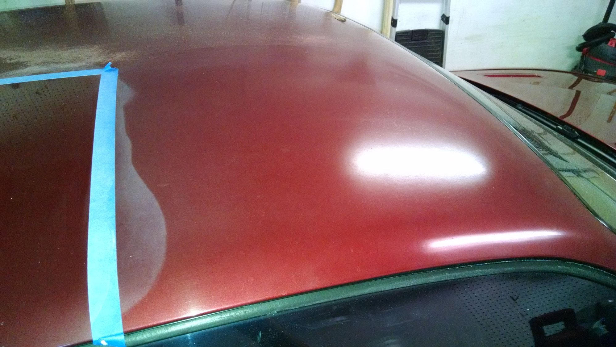

Before:
Here are the only in-process photos I have, but you can see the difference is night and day on the roof:
This picture is a good representation for the entire passenger side of the car. You can tell how oxidized the paint is, see a little bit of the swirling and the hard water spots that had to be compounded out.

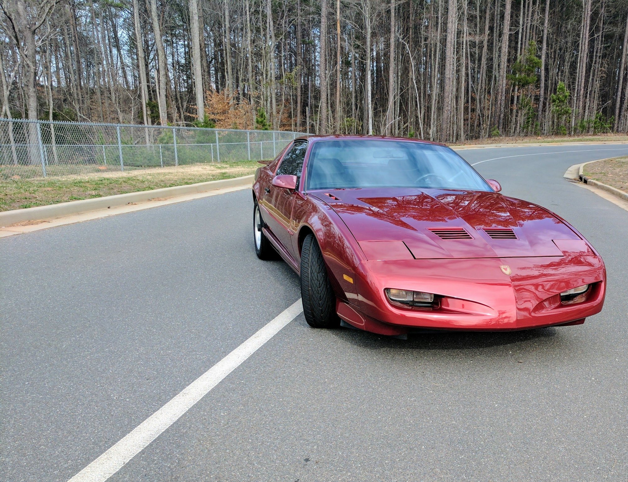

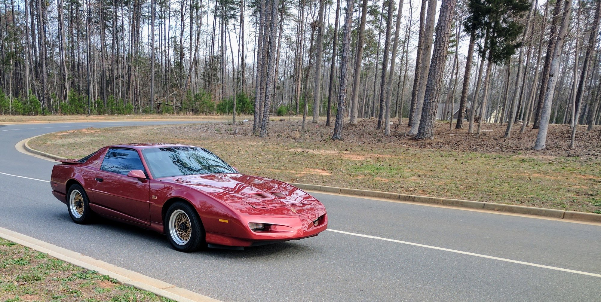

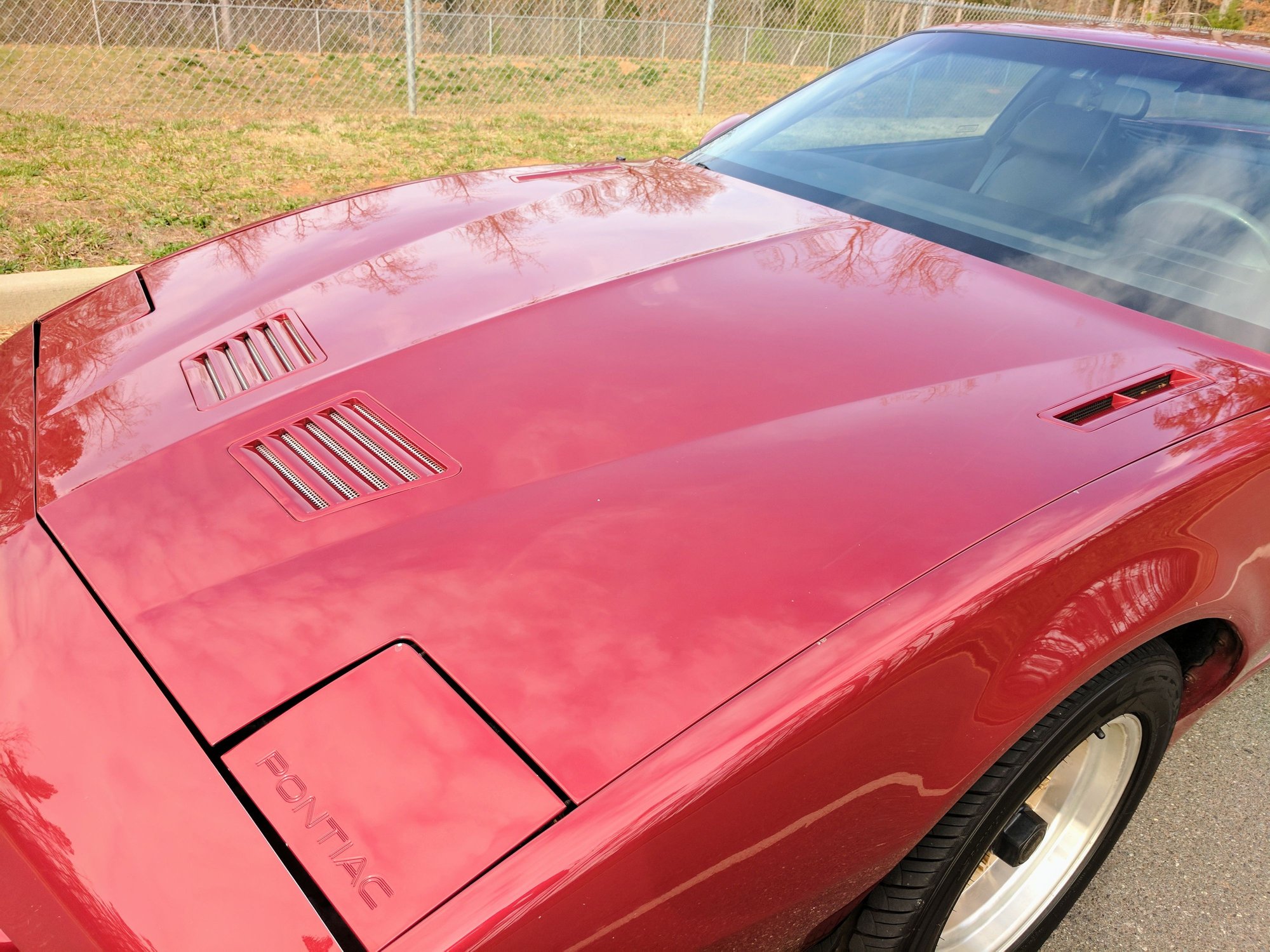

Here are the after shots. Keep in mind it's still not 100% due to the clear coat problems but also because I only had one polisher and pad size to use. There were a lot of smaller areas that either got skipped or didn't get corrected as well as they could have simply because I couldn't get in there with the polisher.

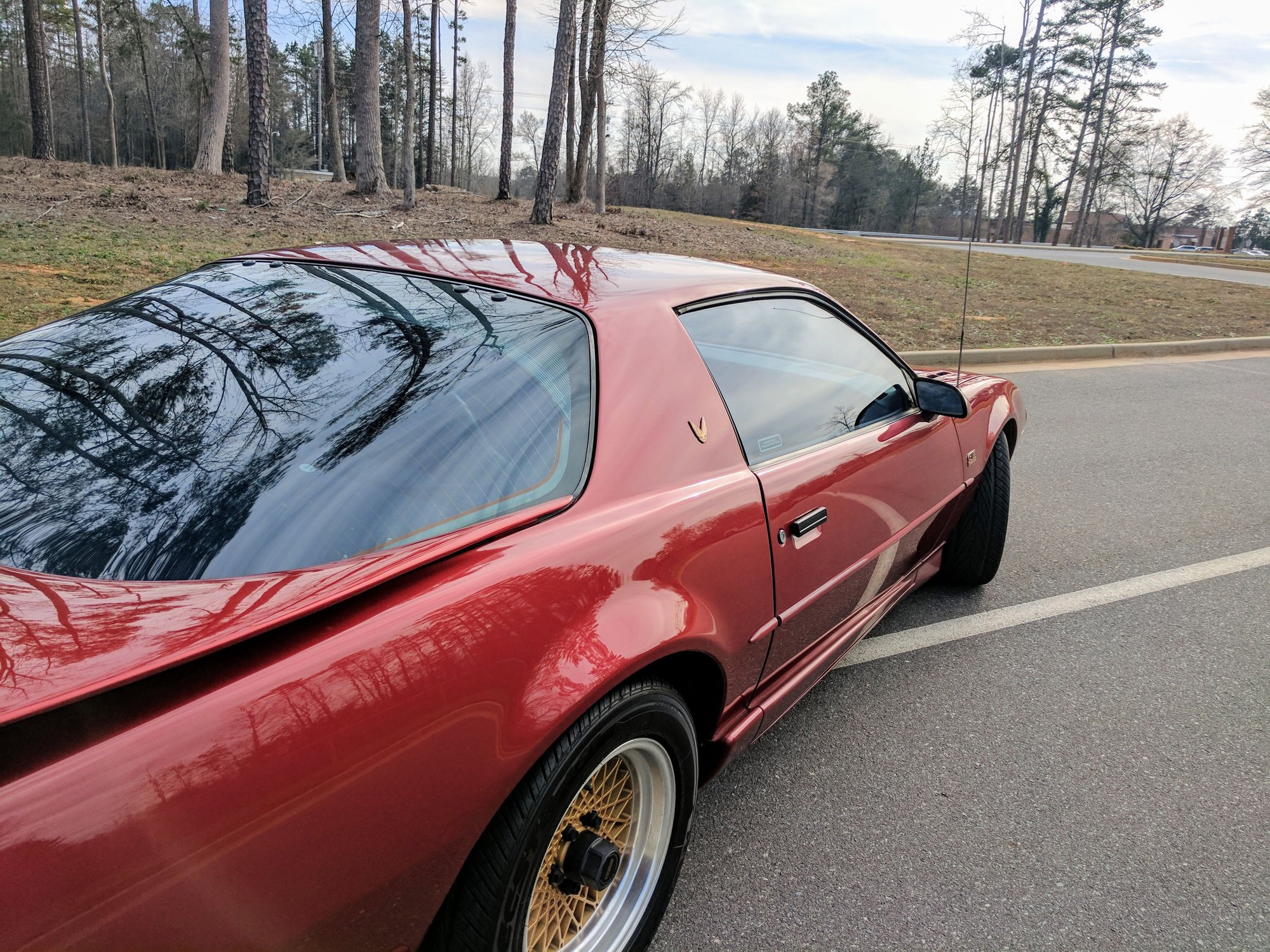

After:
From the corner of the window running to the back glass is where the blend is for the original paint to the repaint. This used to be VERY noticeable. Now you can't even tell it's there.

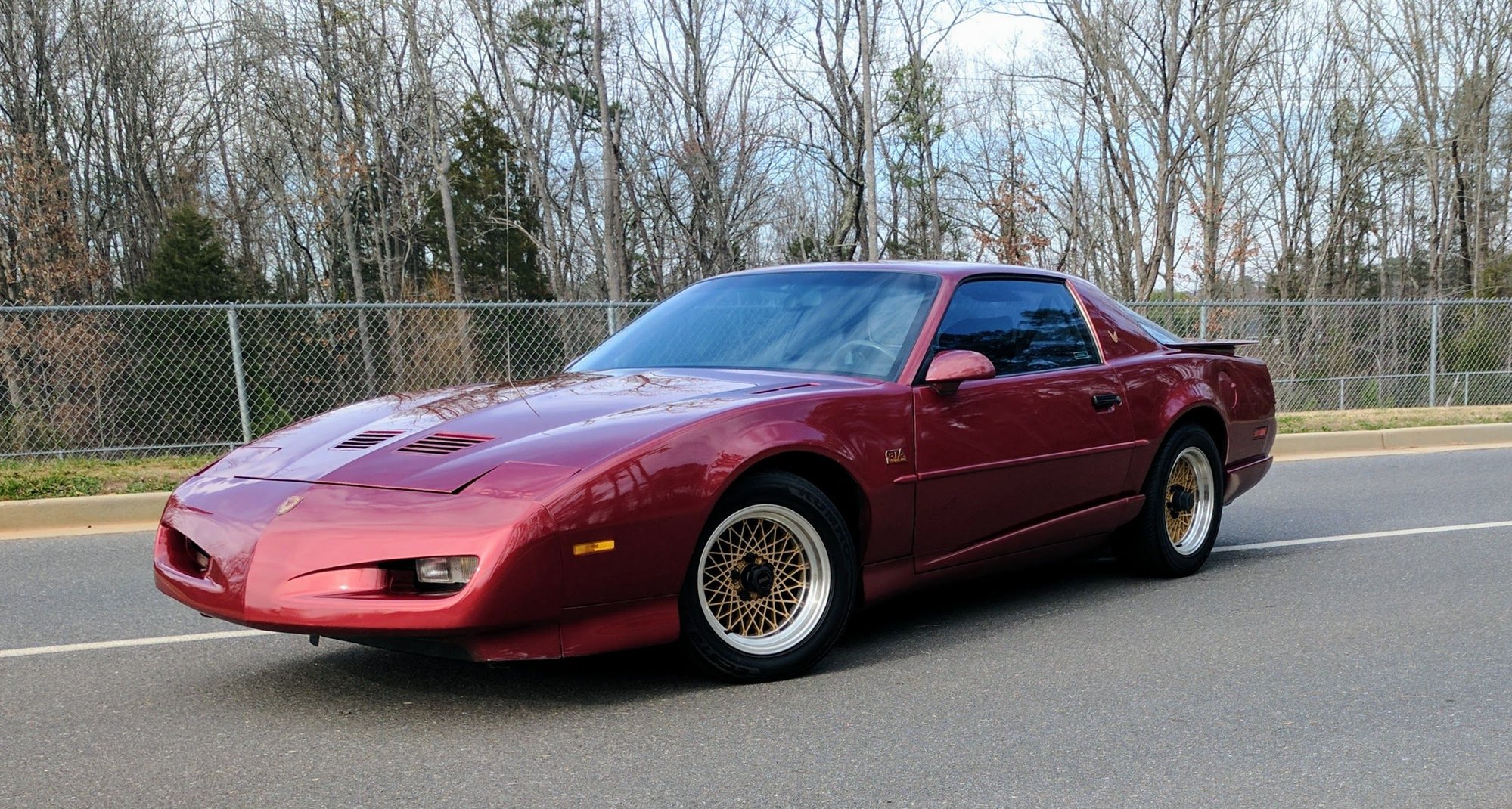

More "after" shots:

The paint looks good, but what's going on with the headlight doors?
It's a result of a run-in with a deer most likely. The PO said they "rebuilt" the left front and probably had the whole front end apart to fix the damage. It bugs me sometimes but not enough to go fix it...yet.

There is adjustment in the headlights. It takes some patience, but you should be able to get them lined up better then they are. Hopefully they straightened the crossmember enough that there is still adjustments to be made.. The car looks good. Too bad the clear is shot on the roof because the rest of the paint came back.
I'm sure if I actually messed with it, I could get the headlights lined up better.
The roof actually came out really well. You can hardly tell that the clear has failed there from a glance. It's the rear bumper and mirrors that still look somewhat bad. That's because I didn't bother to compound all the dead clear off because then I wouldn't have any clear at all left on those panels. So I just buffed and polished them a little bit.
