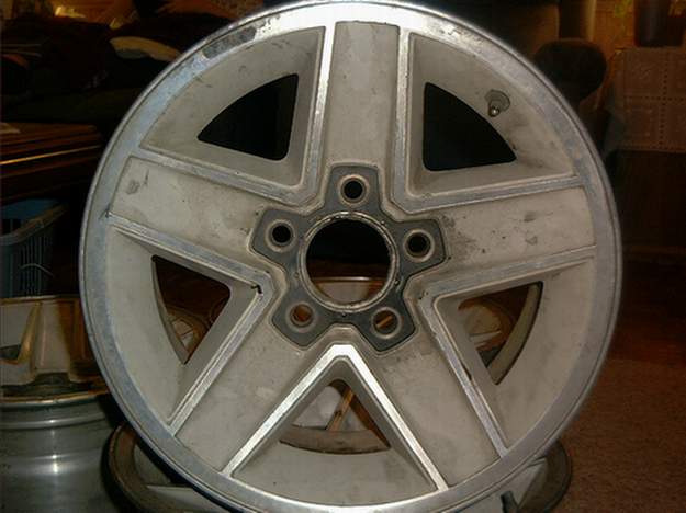

Heres one of mine.I'm working on my test rim at collage, I will get rid of the waves in the polish by milling it flat. I did this to one of the spokes with a 1/2 inch end mill but since I had to make three passes at it.I got the wavs out but the three passes I took the sideways waves out but there was 2 lines going up the spoke.Tomorrow I will use a 1 1/4 end mill to get rid of the 2 lines.

Man... that looks pretty cool. That'd be awsome on almost any color. I wonder how it'd look on my 2 tone, cause I could get another set of these wheels for not a whole lot I'll bet... hmm.

wow those rims in the pic look really nice so far. whatd you use to take the clear coat off and did you spread it over the entire rim? could i use some kind of sanding tool on a drill to get the cast off? i heard a dremel may leave blemishes. Could i just sand them out? Thanks

I used Laquer Thinner. I put it all over the rim.
