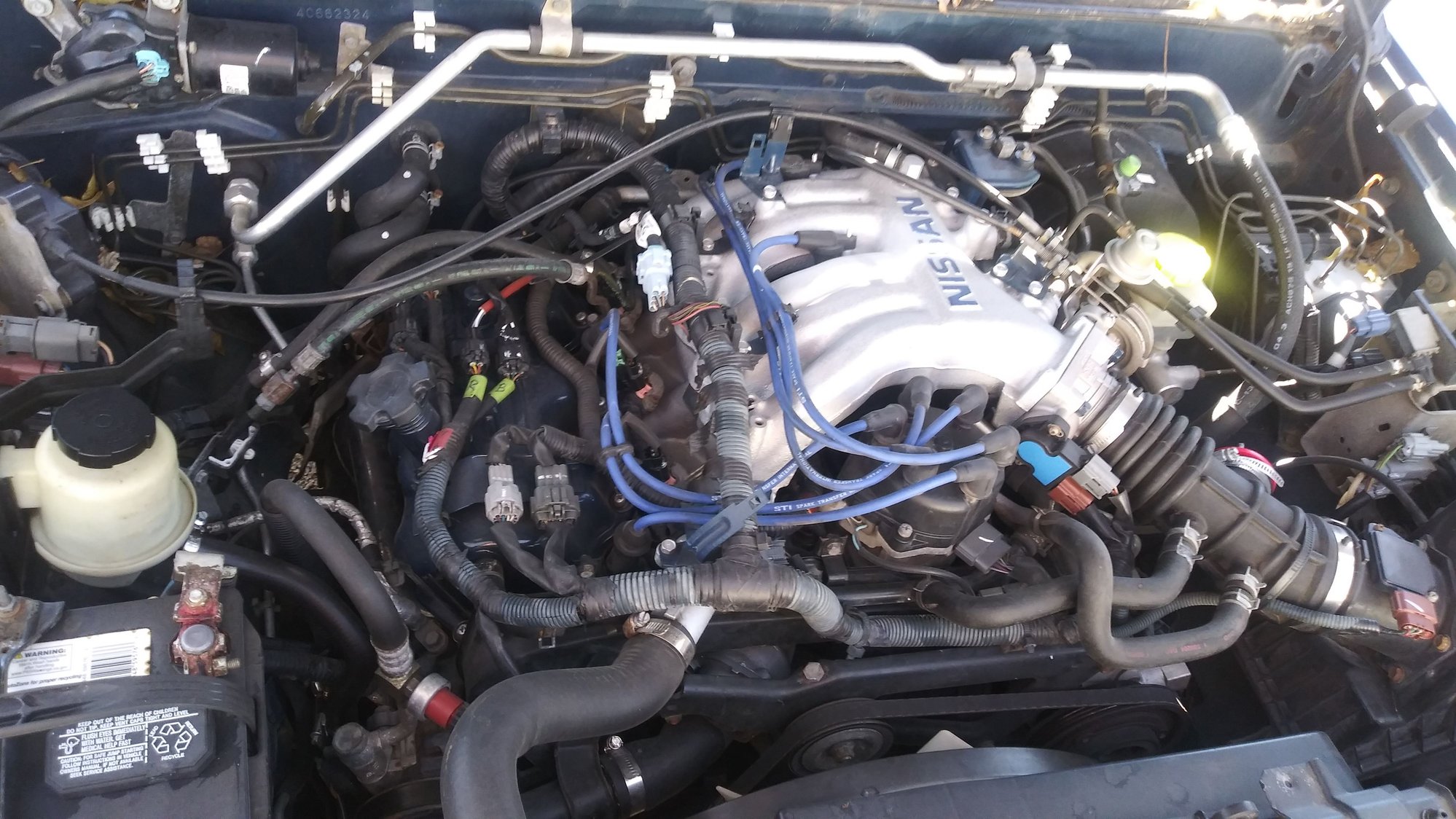

Typical organic dirt like dust, pollen, and road grime, go with the Simple Green. Greasy oily mess anywhere, go with the Superclean or ZEP degreaser. Spray liberally on everything, allow it to sit 5 minutes, and rinse with a hose and spray nozzle. No need for a powerwasher. Repeat and even work real bad areas with a paintbrush. Repeat until clean. Fire it up and go for a 15 minute drive. Come back and park with the hood open until everything cools. IF...it's all clean you would now use a dressing to make everything look new again. Use some aluminum foil to cover up the drive belts first. Here is the engine of my daily driver/tow rig '04 Xterra........hasn't been detailed in roughly 12,000 miles. Makes a BIG difference when you need to work on something too, you're not digging through muck. When I had this thing aligned a while back the guy at the shop said he couldn't believe how clean this old Nissan was!
