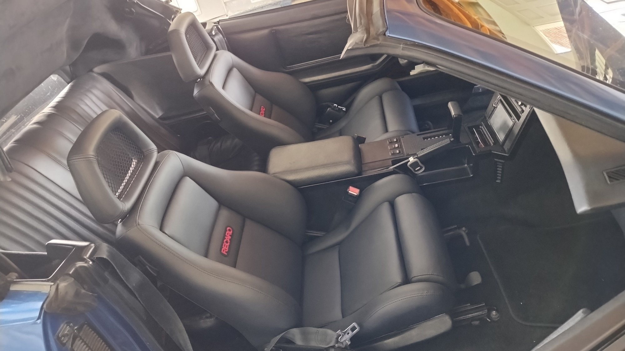

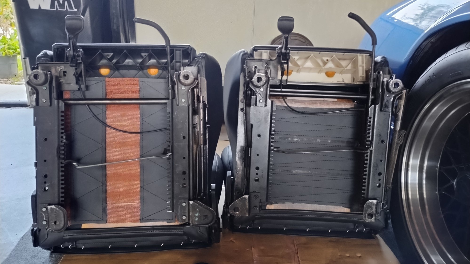

Finally finished installing these after making adapters for both tracks. Switched to 4th gen manual seat tracks with the pivot feature. Which make the seats sit a little higher than they normally would, but only by about 1/2 inch. That said they fit better than the stock (4th gen) T/A seats did. The recliner ***** dont rub on the retractor or the center console and the head rest just clears the visor on the forward incline.
With adapters installed.

Thanks, only wish id gotten them a long time ago.

Thanks guys. They're quite a difference from the 4th gen t/a seats. They feel like they're wrapped around me, firm, but still soft.

Those looks fantastic! Anyone sell the 4th gen seat tracks or did you take them off the TA seats you had?

Thanks, i got both seat tracks at the JY. One i modified for my passenger seat, cause i like the pivot feature on it. Both tracks are 4th gen t/a and dr. side. I had power on the dr.side w/ the T/A seats, but never used it. So i decided to use the manual track on the recaro seat.
