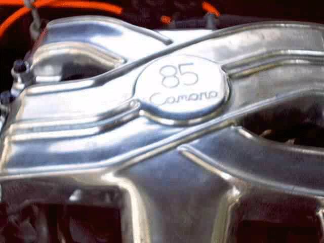

Looks good. When your finished it should look awesome. I did my plenum too and machined 85 CAMARO into it. enjoy

I personally say using polishing wheels is the only way to get the best shine out of what you are doing. The steps that I use are as follows.
1. Use a die grinder with 120 grit and get in all tight areas or ones that a polishing wheel wont get.
2.Use 400 grit with the die grinder going over all spots that were covered in step 1.
3.Use the da sander with 180 grit to get every where else that needs to be sanded.
4.Go over the same areas with 320 grit with the da sander.
5.Use a blue wheel(made with carbon fibers)and use black grease compound. Go over all areas and get out all casting marks and scratches.
6.Use a yellow wheel(made from cloth) and use yellow grease compound. Do the same as step 5.
7.Clean the part and dry it.
8.Finish it off by using a buffing wheel and use white grease compound.
Those are my steps and they work pretty good for me.
