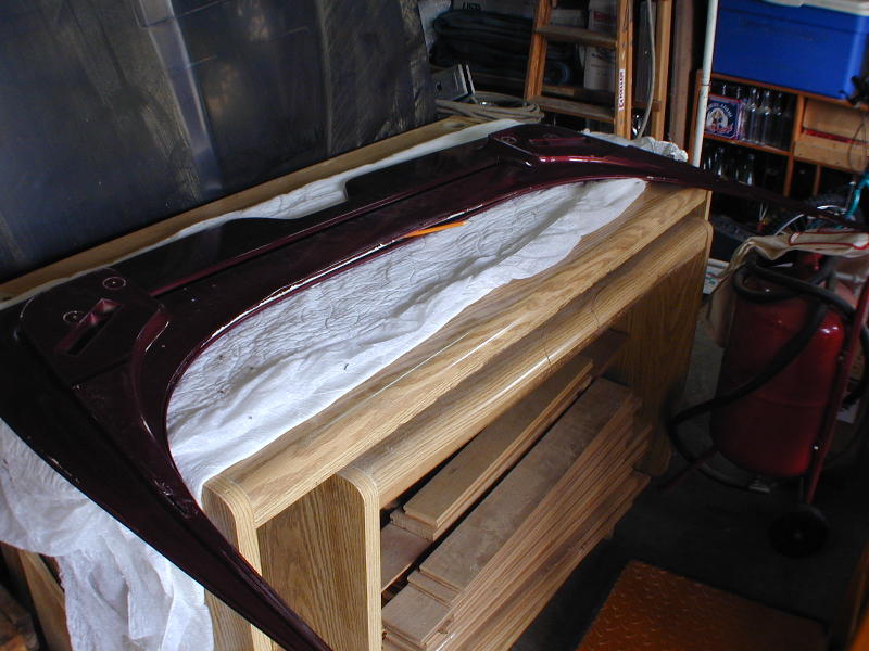

My 1990 firebird has been modified
with a 91-92 style spoiler.
It is the large wrap around piece.
Unfortunately the top and bottom halfs are
separating.
I would like to glue them together
but am not sure what I can use for an adhesive.
separating.
Hmmm....
Although I think this thing
is from a 91-92 car
it might be aftermarket.
Markings on the wing...
VT 2029
PT NO 10179101
MAT XENOY
PET/PBT
Here is a picture
of what I wish to glue
Any advice would be appreciated
is from a 91-92 car
VT 2029
PT NO 10179101
MAT XENOY
PET/PBT
Here is a picture

The wing is made out of something called xenoy
There is a site ...
http://www.urethanesupply.com
that describes xenoy as a polycarbonate
blend.
They also have a string of seemingly well
written "newsletters" describing most of the
plastics I have ever heard of and quite a few I
have not...
Of course they plug the stuff they make.
I am going to give them a try....
I am just a bit cautious due to some painful
lessons from my motorcycle days ( 80's ) :-)
Its worth 20.00 bucks for me to find out...

I ended up using a product available
at my local body shop called Duramix 4040.
It is somewhat hard to use as you must
use their injector setup that uses
a special mixing tube.
Once you start ejecting this stuff you must not
stop as it hardens in the tip in about 60seconds.
So far it seems to harden roughly like
a thick POR 15.
