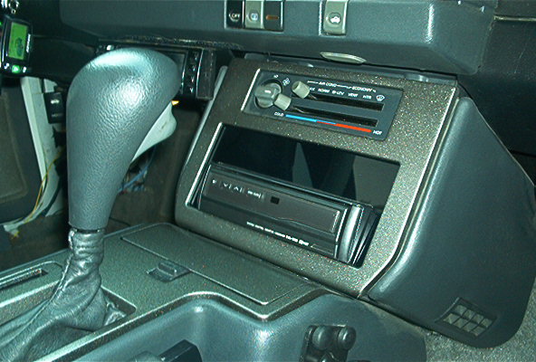

Well I got my console and radio trim done! Whaddya think?
Props to flyinlow89 for the color and idea!

very very clean. Nice install. Was the dvd player a full 1 din? I always thought that a 1 din receiver was too deep for the firebird radiopod.

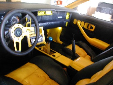

loox really good,how much was the dvd stuff?

I'm a car audio dealer, have been for about 6 years so the system wasn't that much for me. I have the system for sale right now if anyone is interested. It is a CVA-1000 Alpine monitor 6-disc changer and 11 band graphic eq. Plus all of the stuff to put the digital eq display in the rear view mirror and all of the video inputs for the monitor for DVD I want to get $1200.00 for it all minus the DVD player itself (that still belongs to my store). I just want to sell it to get the Kenwood version of it that I sell right now. I'm not an Alpine dealer anymore.
I took the whole radio console out and cut the plastic supports off the inside. Then to get the angle that I needed to clear the gauge bezel i had to custom build aluminum brackets to place the DIN sized monitor clear at the bottom of the radio opening. I also had to cut into my heater vents to get it to sit that low. I did almost all of that with the radio console out of the car. Then I trimmed the monitor with smoked plexi and painted the back of it black. The changer is flush mounted in the passenger dash area right where the map pocket is. That required a little cutting as well. It is trimmed in black plexi as well. My passenger vent is blocked off though. It actuall isn't all that hard just time consuming to get it all to sit just right.:rockon:
