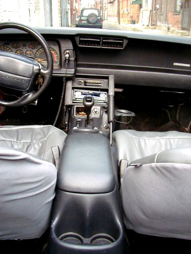

I know it will work!!! Check this out:
Guess i'll pm him.
Old Aug 3, 2002 | 09:40 AM
Tonyrodz's Avatar
Joined: Mar 2000
Posts: 1,611
From: NJ
Transmission: auto
Just change the auto plate to a stick cover plate--and it slips right in--no mods at all.

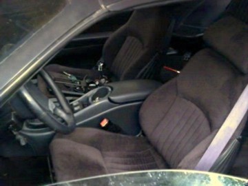

another angle.

Yes i believe it can be done also, but i think your must move the shifter either left or right a lil and it will fit,
