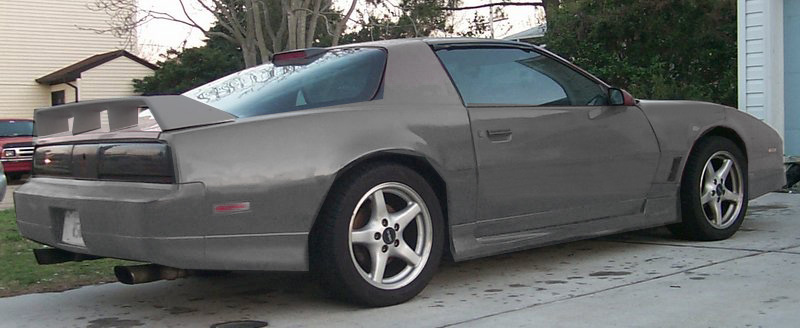

Here's Manny's car (Zepher):
He has a 4th gen rear end (so he doesn't need spacers back there) and i believe he has 1.75 inch spacers up front. (not sure on the front)

I have the 2.25" spacers on the front.
You can see the spacer on this picture,
