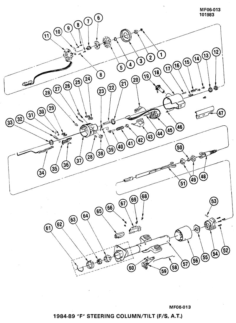

The column could be shot or the screws inside are loose. I thought mine on my old 89 was shot too and bought a new one, while tearing the old one out I noticed the star screws and they were loose and tightened them and the tild worked fine again. Not saying that was what is wrong with yours but worth a shot. Buy another one take yours out and see, just in case it's not you still have the other one to put in!!

Same thing with my 84Z28. Takes a little time, but you will most likely find that the bolts inside have just come loose. Well worth the time to take it apart a tighten. Keep in mind the signal light cancellation when you put it back. Friend of mine had the same problem with 2nd gen.

Yeah I think everyone with tilt wheel has or has had this same thing, I tore mine all the way down there are 4 bolts that hold it tight, it's a pain but much better when done. I had to repace the ball bearings while in there.

The screws at #52 are what they are talking about. They do work their way loose and make the column feel "sloppy". Use locktite on them before tightening them back up. Just take your time dissassembling and watch where everything goes and how it interacts with other parts and you'll be ok. Save that money on a new column.
Jay
