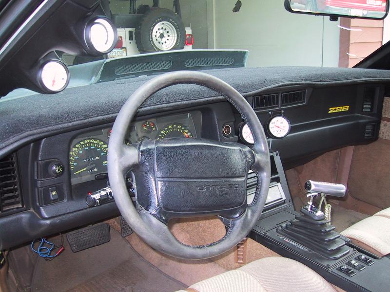

it was really easy heres a pic, if you want, i can send you a pic of under the console, to see, also not mentioned earlier, the neutral safety switch. it is easy too.

You guys have some REALLY nice looking shifters! Well...I went to the shop where I get most of my mods done.....they said they would charge me betweet $100-$150 to install it!!! Thats pretty expensive..! I just stiil not sure I'm cut out for this kind of job....but..please keep posting your pictures and thoughts of installing the B&M Mega Shifter....

Here ya go with Hammer handle

here yah go

iceblue man that looks awesome. Good work!
