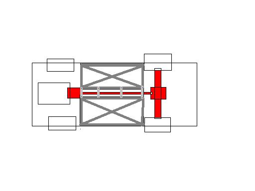

Ok so I know that I will need to weld in some sub frame connectors, and add a strut tower brace. Are there any other braces or anything else, besides a roll cage that will strenghten the body? I was also thinking about making a frame of some sort from the firewall to the rear end on each side and connected together with removable bars. I'd probally use 2 by 2 square tubing, Whatcha think?

uhhh....yeah sounds good! wait bars from the firewall to the rear end? wha? might be unnecessary if u got sfc's. i dunno
Old Apr 9, 2003 | 11:45 PM
BTS88IROC's Avatar
Posts: 957
From: Mesa, AZ
What do you mean by bars that go from the firewall to the rear? Also if they are removeable I don't see them being of much strength

This is hard for me to explain so I'll make a pic in paint, but the removable part will connect the two frame's in the middle of the car.That way if I ever need to remove my drive shaft I can unbolt the middle pieces to remove it. The frames on each side of the car will be welded in. I'm pretty sure SCF's will do fine, but more bracing is good too

forgot the pic

I belive your exhaust would be in the way on the passenger side.
However, thats just a slighly more complicated system of what some of the mid 90's vettes used.

I think the frames will be overkill, but just to be safe I'd be much happier doing that and knowing that the car wont bend in on its self. Theres gonna be lots and lots of pics during my project

if you weld those cageish lookin things on the bottom, how would you do anything with the exhaust if need be?
