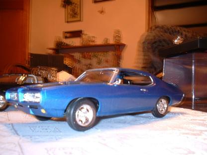

heres a candy apple metal flake blue, i love this color
edit: sorry pics blurry

technically it's either metal flake or candy........

lol ill have to check the can again. i think the blue is just the metal flake and the red is the candy but im not too positive, the cans are in the garage so it will have to wait
