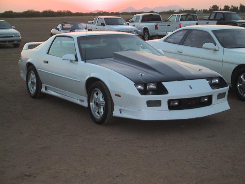

I was qouted everything from $200 to $450 to paint my harwood hood. So as the title states, "i'll paint the freakin' thing myself. To be honest I was a little worried about messing up but I think it turned out pretty good. If you are thinking about painting something on your car, do it yourself and save a few hundred bucks. Here is what the hood looked like before painting.
This is what it looked like after painting.
Installed
Last one

Also, do you have the nasty Harwood gap? The top-down view shows a major shadow on the front...
Yeah, I have a little gap but it's not as bad as it looks. Looking at the picture it looks like it is huge but it's not really bad at all.
