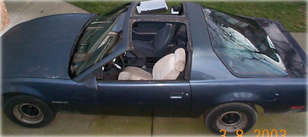

i think i have vette seats, the guy i bought the car off said they were from a vette....there real nice tho, u can turn these ***** and make the seat squeeze u more loose, and they got extendable leg rests too...there real comfy i just gotta get them reapoulstered. a dog got at teh passenger and ripped teh faom all apart. heres a pic hope it helps

I have had lots of vettes and none of them even had those *****
sound more like recaros or something
