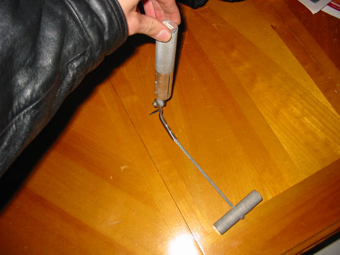

You can buy a tool that will make it a ton easier to pull a windshield at home. I'm not sure what its called, but it came from a local body supply shop. The blade at the bottom goes in and under the glass, and then you hold both handles and pull it all the way around the windsheild. I have pulled 2 thirdgen windshields with it, and it definitely makes it easier.

another pic
