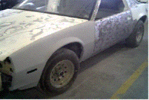

sandblast it all, and then take a pick hammer and try to dent all the rustspots, the spots that dent easily have to be replaced because the rust has penetrated to the backside, and of course rustouts will have to be replaced with new metal. Definitely sandblast it though, then you'll be sure to get the rust out of all the pits. and USE A SELF ETCHING PRIMER It's a good corrosion protection.
there was plenty of rust on this bad boy.

Just dont sandblast any body panels or chances are theyll warp and become rippled.

yeah 88 WS6--------- does have a good point, sandblasting does create alot of heat, but I haven't warped anything yet. u should be alright as long as it ain't aluminum which you won't find on a 3rd gen.
