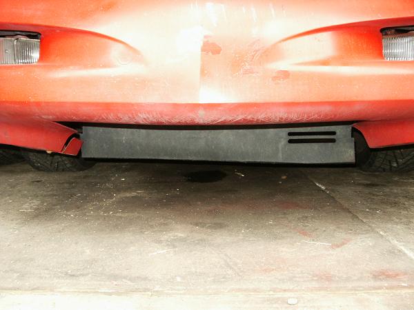

I have attached a pic of my newest Formula (non fog-light, non ground-effects) nose. It's the 3rd one I've bought for my car so far... I'm actually going to use this one. It's brand new but the guy had a bodyshop paint the edges & then he realized he needed the style with the ground effects.

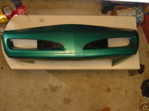

I'm a bit confused... I cant see any difference in the opening for the formula nose and the one you have...Of course the geffects isn't there, but the openings for lights seems the same to me...
Oh so your the one that won that off ebay ? he he glad someone off her got it I was gona get it for a spare. Oh and on the other note on the formula one it has those black things that block the fog lights and on the TA nose it does not have those. Look closer at the one with the GFX (TA nose) and the one without.

Yes I do see the difference with the black grille and all. But still, to me the opening for the lights seem to be the same size.
The reason I'm wondering this is because the seller (yes I was the one who bought it) has listed 2 lights for the nose. Help me out here, is these the right for the nose? One of them is foglights.. or so he says..

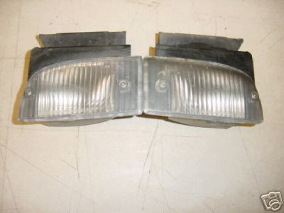

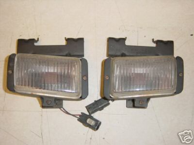

and these.. both are supposed to be used...Is that correct?

You can use both of them BUT! you will have to remove those black grill things as you call them know as fog light delete panels I guess. I know someone else has used the formula front end and used the fog lights with the turn signals. they will both fit yes if thats what your asking. First ones are turn signals second are fog lights

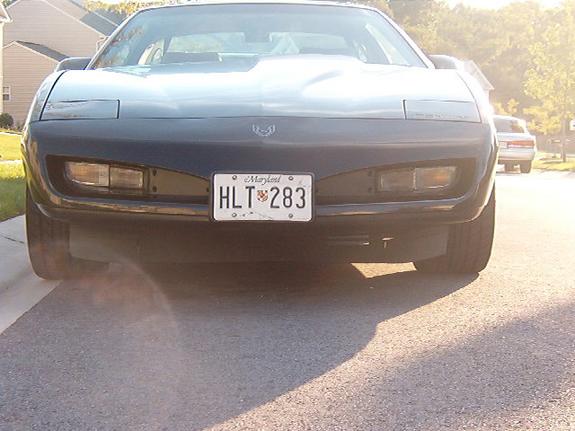

if you look closly at this pic you can see he cut part of the black out off

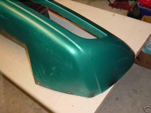

k see the areas I have circled in red thats where he cut, but it was just the fog light delete panel not the cover its self just the panel that blocks the area where the fog lights would go. the dark black area is the delete panel and the light black is the bumper cover its self

I'm using the camaro airdam as well. Is this the one you mean?
Attached Thumbnails 91-92 bumper conversion (firebird)-c-documents-settings-administrator

That looks very different from the one on my car now...This guy said he had some more parts to it, what he described as:
" Hello, I do have the The Black Plastic that hangs down. But it is actually
mounted to the Core/Radiator Support. Is this what you mean??"
So yeah, is that what I need? Lol
But then again, the one you have might be different since it's for a ground effects car, Mitch DoGG.....?
thats not a camaro air damn your just missing the side skirts to yours
