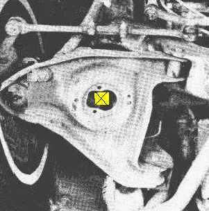

oh man, ya live ya learn. Im sure your glad it happen on a car you owned first. Them lip jacks are for only small small import cars that weight 105lbs. Allways jack of the frame or supension parts. I either use the shock nubs on the rear end or the front a arm for jacking.

this thread has several images of the jacking points you can use.
