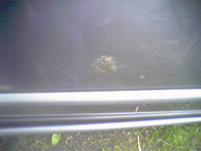

I have 3 spots of rust on my whip, this is one.

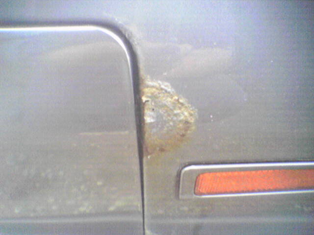

this is the worst spot.

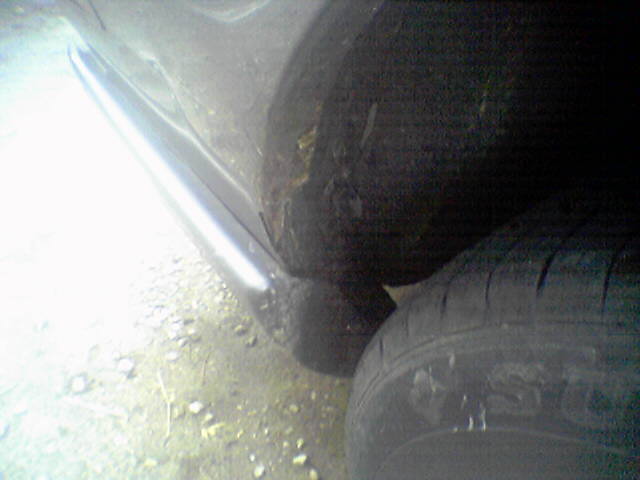

Depending on what it looks like under and behind on the door. I would first sand out the area, and use a spot sand blaster to remove the rust. and depending on how had you can either cut out and weld in a patch.. would on the door would be interesting to make sure the panel doesn't warp. or use a bit of fiberglass over it instead. and finish it off and repaint .. As for the rear fender part. it's a bit tough to tell .. but probably the same process as mentioned above.

and this is the last spot. I'm wondering if anyone can tell me what the best way to get rid of these spots would be and how would I do that?

Spot sand blasting is the best way to tell how bad it is after the rust is removed. If you sand it you can end up sanding through high spots and actually hiding some of the rust.

for the wheel well, i'd just cut it well above the infected area and either get another quarter to weld in its place, or mold one. for rot spots you MUST cut away the infected pieces or they will keep returning. the others look small enough to sand. i'd have that done asap, rot spreads quickly. after owning a rotted car, i will never even think about buying one again. i'd rather have a perfect frame then a 10 second rotted car

POR-15 works great on rust but yours is in some highly visible areas. I would also find a donor car and cut out some metal and weld it in place. If you cant do that try getting a couple quotes from a body shop.
