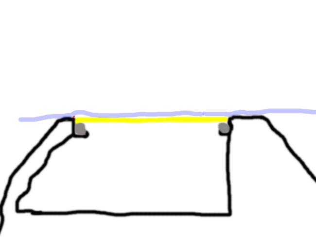

originally posted by Kandied91z
the only thing i question is wind noise while driving...
If done correctly, you will hear just as much wind noise as regular t'tops or less. All it would take is a flange on the center edge where the top and windshield pillar meet. Have it where you angle the top and the flange goes under the pillar and when you lay the top down it keeps the center section from bowing up.
Course one could eaisly make a miniscule wind foil about a few millimeters thick and 1/8th of an inch high above the roof's surface where the wind will be forced to go over the leading edge of the targa top. That would solve some wind related issues.
I attached a pic, sorry for the lack luster drawing I cant draw.

nice pic, free hand ic...
