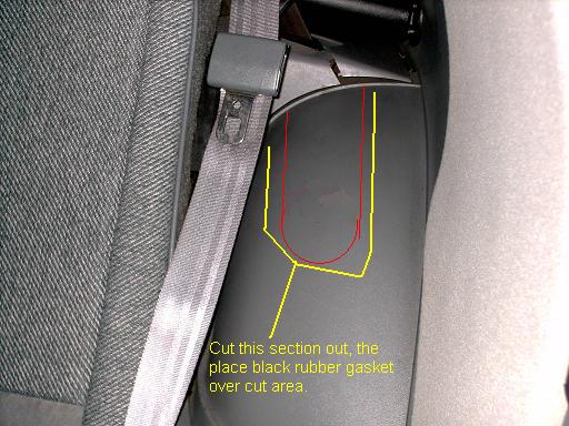

well, I got to looking at it..and it looks like this would probably be the best possible way. If I did it like this....I probably wouldn't even need to take my plastic out...that would save alot of time....
Attached Thumbnails I got my roll bar today..and I need your help installing it-stuff.jpg

it would look kind of like this....you think this would look tacky or anything? I think it would be cool to rush maybe "brushed aluminum" to cover the hole with....but..I dunno...black rubber would be much easier to work with...
Attached Thumbnails I got my roll bar today..and I need your help installing it-stuff2.jpg

yea.. it would look tacky in my opinion..
not bad enough to be a hack job, but not good looking either.
its one of thoes detail things that takes a lil extra effort.

if done right, hell no. if you take a close look at the link that you posted to another tgo thread, you'lll see that's the same thing he did. it looks good if it's done right

I think it will look just fine!!

alright, here it is. I absolutely had to cut the plastic...I hated to do it...but it was definently necessary. The installationa bear...me and my dad to get it in...and twist and turn everything...I thought I was going to bend the top...but...didn't. Now....I just have to work on making those panels...(if anyone has any ideas, shoot'em my way)...and I have to cut my rear floor mats to cover up the plates. I think it looks great though

Damn, thats a pretty good job their custom. You can always take it to a body shop and they could make something for ya easy, probably wouldn't cost you more than $50 either. Im not too great when it comes to fabricating something to look good to, so thats what I would do, im sure you have more skill than I do. Anyways, I need to grab me one of those, I got 2 new leather racing seats in my car and I wanna put some 4 point harnesses in it.

nice job. Guess thats a whole lot easier then my way but hey, its done and im sure you like it.

Old Jun 1, 2004 | 03:32 PM
Sickness91Z28's Avatar
Posts: 4,226
From: Chesterfield, Indiana
Car: 1991 Z28 Camaro
Engine: 5.7
Axle/Gears: 3.23 For Now
get'er done
went to the hobby store and bought a few sheets of black rubber foam. Made a pattern, cut it, installed it in place. What'cha think? It's really the only thing that could be done....
Attached Thumbnails I got my roll bar today..and I need your help installing it-cage3.jpg
Old Jun 1, 2004 | 03:50 PM
CaptPicardsZ28's Avatar
Joined: Oct 2003
Posts: 2,069
From: ready room
Car: NCC-1701-D (docked in AZ)
Engine: impulse drive
Transmission: fusion reactors
Axle/Gears: Rescued from the Borg by my crew
Re: get'er done
Looks great! Good job!
Old Jun 2, 2004 | 12:50 PM
Nate86's Avatar
Joined: Jul 2003
Posts: 1,104
From: Pensacola, FL
Car: 1999 Saturn SL2
Engine: 4 cylinder
Transmission: 4-speed automatic
That looks absolutely fine. Great job.
Old Jun 2, 2004 | 05:15 PM
megaracerx's Avatar
Joined: Oct 2003
Posts: 1,297
do you have to drill holes in the floor boards? i cant think of any holes that are there to start... i would love one but i really dont wanna drill the floors myself...how much to get them installed..?
Old Jun 2, 2004 | 09:43 PM
Posts: 4,226
Engine: 5.7
yes, holes have to be drilled in the floor pans for the front bars to mount. 8 holes total, and then backing plates go on the other side....very very simple. If anyone decides to get one, make sure to have alteast one other person help...because it's such a tight fit...and because of the shape of it..it's hard to handle.
