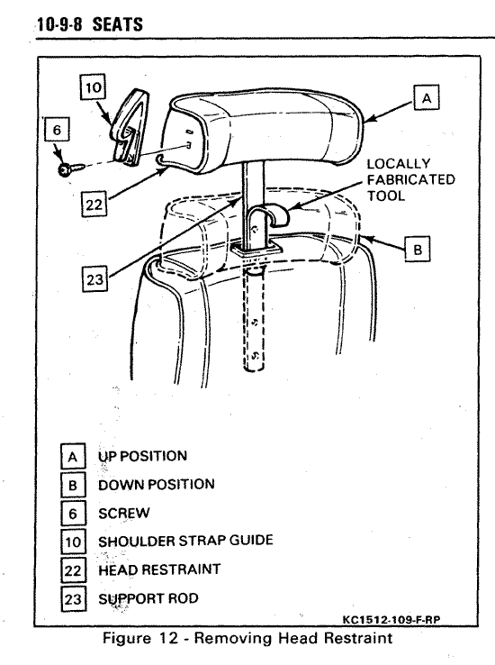

Hello I purchased a Set of Seats from Ebay for my 87 Bird. The seats came from I believe a 89 Camaro not to sure but not to sure that matters that much. The seats came but came with the head rests off and I've tried many diffrent things and cant get the darn things on, any help would be great thanks.

Maybe this will help

Hey thanks so much, what I used was a painters mix stix. My dads a painter so we had them laying all over, I broke it off inside there but when I pulled the head rests up it came out so, thanks I'll get some pictures of them on heres one with out them.
