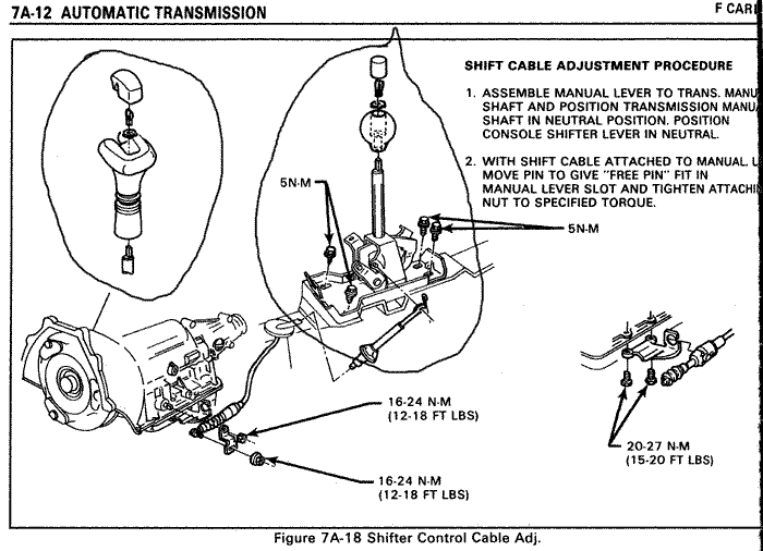

Not all auto shift ***** are the same. There are two different kinds on thirdgens, which require two different shifters. Unless of course, you plan on busting out the dremel.
My 86 originally had the round shift **** on it. I bought one of these:
It didn't fit onto the shifter arm unless I modified it. Slow88lb9 was gracious enough to send me a shifter he didn't need anymore, and it fit perfectly.
[edit] As for your application, the IROC **** should fit fine in the RS.

Cayse is talking about the old round ball type shifter **** that had a "C" clip inside the **** that held it on and he is correct in that the new style would fit on there. But there was no way to secure it without some modification and vice-versa for the old style replacing the new style. Best way to remedy that was to replace the shifter assembly as well.

Any GM shift **** that is the staple type will work in your 89 RS. the older round ones with the clip on top won't

The only ***** that are threaded are the manual transmission shifter *****. The automatic shifter ***** on our cars are held in place by a steel "U" shaped pin that resembles a big staple. See picture below. The older style round ball shifters that were mentioned earlier were held in place by a "C" clip inside the ball **** and the **** was removed by pressing down on the **** until the clip was exposed and using a small screw driver or pick to remove it. The **** was then removed by pulling up on it. A few people who didn't know about the clip gave themselves double hernia's trying to pull the **** off. See the second picture for the old style.

Just a minor correction for anyone that's planning on doing this, the **** doesn't move down the shaft unless it's broken, so you do not have to push it down to expose the C-clip. A C-clip tool is your best bet (got mine at Sears hardware), but a small screwdriver and some aggravation will do just as good.
