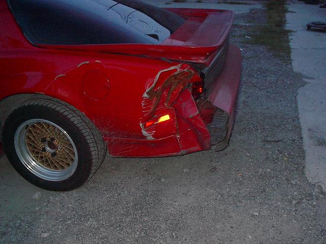

Old Jul 7, 2004 | 06:25 PM
RedGTAWSU's Avatar
Joined: Nov 2003
Posts: 133
From: Detroit, MI
Car: 1989 Pontiac Trans Am GTA
Engine: L98 350
Finally...come pics.
Old Jul 7, 2004 | 06:26 PM
RedGTAWSU's Avatar
Joined: Nov 2003
Posts: 133
From: Detroit, MI
Engine: L98 350
Old Jul 7, 2004 | 06:28 PM
RedGTAWSU's Avatar
Joined: Nov 2003
Posts: 133
From: Detroit, MI
Engine: L98 350
Old Jul 7, 2004 | 06:29 PM
RedGTAWSU's Avatar
Joined: Nov 2003
Posts: 133
From: Detroit, MI
Engine: L98 350
Old Jul 7, 2004 | 06:32 PM
RedGTAWSU's Avatar
Joined: Nov 2003
Posts: 133
From: Detroit, MI
Engine: L98 350
in all the pics you can see a silver line inside the hole in the rear bumper. From that point to the center of the car there is no damage to the interior panels. From there out it's bent forward and to the passenger side. The quater panel I have is cut past that line. I'm thinking of only replacing fron the front of the wheelwell back and from the bottom of the sail panel down.
Let me know what you guys think
Ryan
Old Jul 7, 2004 | 07:39 PM
85berlinetta2.8's Avatar
Joined: Apr 2003
Posts: 1,248
From: Ontario
Car: IROC Z
Engine: 5.7
cut it off a car from the wreckers and weld it on
Old Jul 7, 2004 | 07:41 PM
jay92,85,79's Avatar
Joined: Apr 2004
Posts: 1,674
From: glenwood IL
Car: 85z28,
Wow man thats a nice hit.If i was doing that car i would pull it can't tell in the pic but u said it was pushed forward and to the pass. side If its forward and to the side u have to get it pulled.And if u have a full quater i would but the hole thing on go up on the sail panel about 5 inchs from the top. Hows the rear body panel?I might have some pics of quaters i have put on.ANd like ( i forgot who said it) but don't over lap it. Do a butt joint with backing weld solid and grind flat then all u need is one coat of bondo and one coat of glaze.

Old Jul 8, 2004 | 12:16 AM
RedGTAWSU's Avatar
Joined: Nov 2003
Posts: 133
From: Detroit, MI
Engine: L98 350
The rear panel is good from that silver (no paint) line you see in the huge hole in the bumper. The frame itself is straight, but the wheelbase on the driverside is 1/2 inch shorter than the other side. All the "damage" was in the floors. I got the car aligned after the accident, and it came perfectly straight. I don't need any frame work, and I don't need to put it on a frame machine. I'm just going to install subframe connectors to strengthen it.
I'm NOT doing this myself. I kinda want to, but only if I was being watched and helped by a professional that was making sure I was doing it right.
Why all the way to the top of the sail panel? If they did that...how exactly would you keep the roof in the right spot while the quarter is cut off and new one put on? It's a Ttop car...so good fit is important to keep the ttops from leaking.

Old Jul 8, 2004 | 07:30 AM
KEVIN G.'s Avatar
Joined: Jun 2004
Posts: 692
Likes: 12
From: North Carolina
Car: 1984 TRANS AM AERO (PAINT SO DEEP
Engine: 305 CARBED
Transmission: 700 R-4/Vette Servo mod
DO NOT DO A VERTICAL CUT!!!!!! THAT IS THE WORST KIND OF HACK JOB REPAIR POSSIBLE!!!!
The replace to sail panel is the correct repair. Don't worry about the strength. As a T-Top car though, make sure it's sitting on its own weight. (On its tires) If it's in the air, or on pinch weld clamps, these cars are too flexible to count on the lines to be correct. (Ever notice how the gaps change when you jack it up?)
use a good weld thru primer on all the welded seams and a urethane based caulk at the factory caulked joints.
and don't sweat the small stuff... If done correctly, the repair will probably outlast the car.
Look at it this way, you can repair all the rust that's starting at the outer wheelhouse while the quarter is off.
