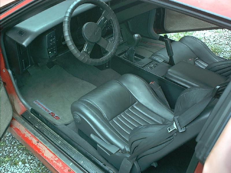

only a little cutting fo the seatbelts could'nt even tell with the seats out
