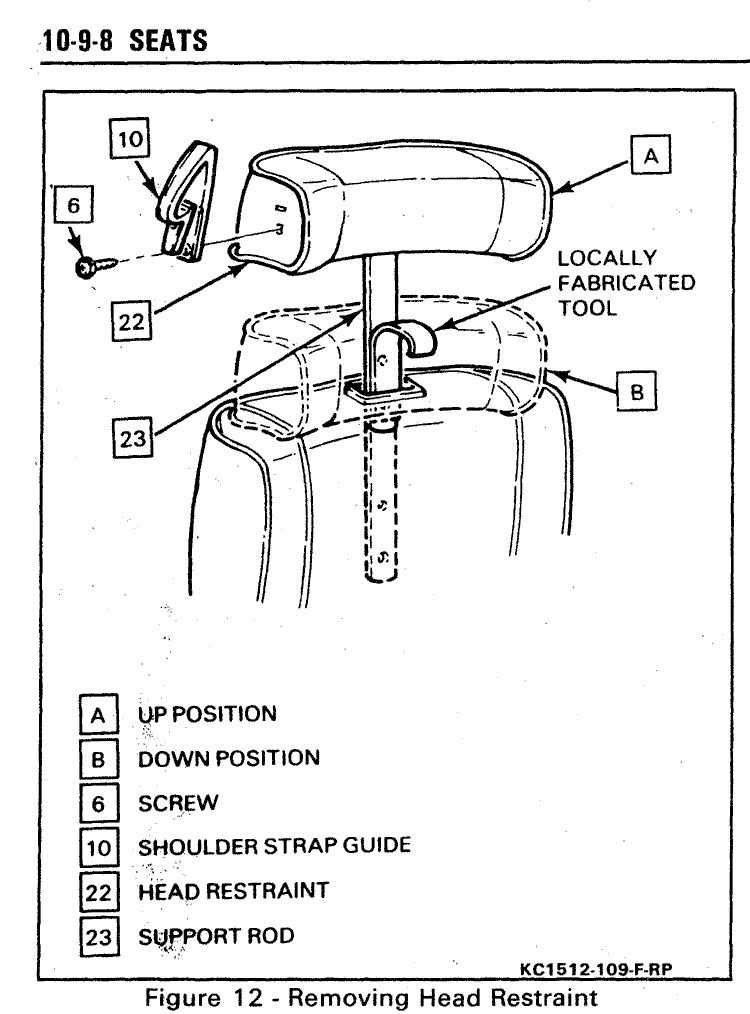

I've been trying forever and i can't figure it out. I'm reupholstering my trans am. I can't figure out how to get the headrest off. Yea this may be a dumb question, but how do you get it off? I figured there must be some sort of catch inside but i can't figure it out.

Maybe these two pictures will help you out with your problem.

part 2

Thanks a bunch. I would have been totally lost w/o these. Can't thank you enough.
