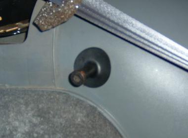

I trying to remove the driver's side rear plastic trim panel to get access to the small storage area. I seem to have hit a snag. How do I remove that metal rod that the back seat latches to? Or do I even have to remove this in order to remove the big trim piece? Here's a picture of what I'm talking about.

look in the center of it, it takes a torx bit, unsure of what size, or if you dont have those, find a allen wrecch that fits well, or all else fails, vice grips around the head of it.

it's a T-47. Get a torx bit that size attach it to a ratchet and turn counter clock wise. should take less than a minute.

Thanks for the help! Funny thing is I did try that at first, but couldn't get it to break loose so I thought there was a different way to remove it. Hopefully I can manage to get it out this time.

I had to use a 1/2 drive breaker bar to get mine loose
