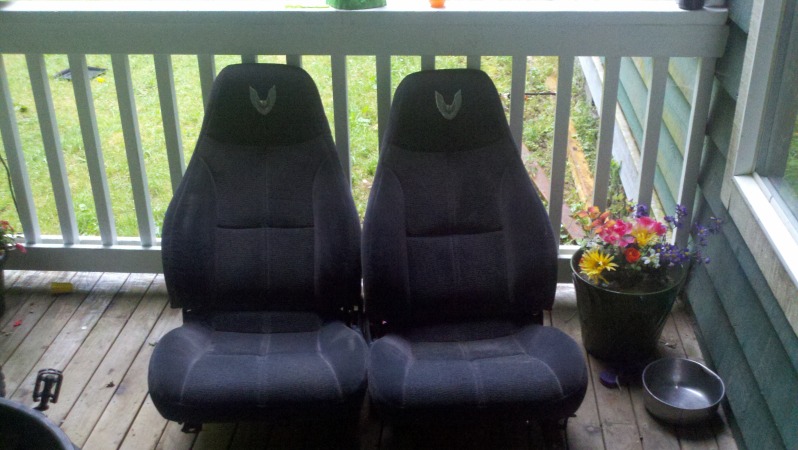

ive been following this thread in the shadows for awhile. lol. lots and lots of good tips in here for weight reduction. just thought id share a pic of some cheap fab work. i have no idea how much weight i saved? but it was definetley lighter than the original bumper. its made out of some angle/bedframe i found in the trash. lol.

So i thought i would share....
I just bought some seats off a guy to go into my third gen, i bought some 1996 z28 seats, cloth, no power.
My old seats are 84 trans am seats, cloth, no power...here are my finding (some maybe rounded if less than half a pound difference)
1996 z28 Cloth, no power, 4th gen sliders
Driver seat 37 lbs
Passenger 30 lbs
Weight of 4th gen sliders combined
18.5 lbs
1996 z28 Cloth, no power, 3rd gen sliders
Driver seat 24 lbs
Passenger 24 lbs
1984 trans am Cloth, no power, 3rd gen sliders
Driver 34 lbs
Passenger 34 lbs
Third gen sliders combined
12 lbs
That is a weight savings of 19 pounds

I'm having a hard time following your weight "reports", especially when you give 2 different descriptions with the same weight......Besides that, I'm not quite following your other descriptions either.
Driver seat 37#
Passenger 30#
Driver seat 37 lbs
Passenger 30 lbs
Old May 20, 2012 | 06:50 PM
Driver seat 37#
Passenger 30#
Driver seat 37 lbs
Passenger 30 lbs
Fixed. I dont know why i put the same info in twice there, the first one is the same as the second, i just put the same info in again for some reason.
basically, the third gen sliders are light, and the 4th gen seats are light, combined, they turn out to be almost 20 pounds lighter total that the stock seats.
other than that whats so hard?
first i measured the seats with the stock rails on them, then i measured the rails (driver and pass) combined, for the 3rd gen seats and the 4th gen seats.
then i measured the 4th gen seats with the 3rd gen sliders. not that hard to follow.

So 4th gen cloth seats with 3rd gen sliders is the lightest combo.. What about 4th gen power driver in leather and 4th gen leather manual passenger, both with 3rd gen sliders.. This is the combo i'll be getting..
Old May 20, 2012 | 09:45 PM
  #491
firechicken76's Avatar
Joined: Aug 2006
Posts: 559
From: washington
Car: 88 Trans am GTA
Engine: 2002 Ls1
Transmission: t-56
Axle/Gears: Ford 9" 4.11 gears w/ locker
Re: The Weight Reduction Thread!
not sure, i dont have any of those seats, I do know that the sliders are what make them heavy, so the third gen sliders made all the difference. cant argue with 20 pounds and extra comfort!
I do hear that the 4th gen power seats are the heaviest around 50 pounds.

that is a HUGE amount of weight for a slider...... anyone else back this up?
Old May 21, 2012 | 06:56 PM
  #493
Joined: Aug 2006
Posts: 559
From: washington
Engine: 2002 Ls1
Transmission: t-56
The driver side slider for the 4th gen is the heavy one. anyone else notice this?
the third gen sliders were the same weight for both sides. That is why when i weighed them, the 4th gen driver seat was heavier than the passenger. The seats themselves though weigh the same. thats also why when the third gen sliders go on the 4th gen seats, both complete seats weigh the same, just like the third gen seats did with the third gen sliders. hope its not confusing.
I hear the reason the 4th gen seats are lighter is because they are graphite.
