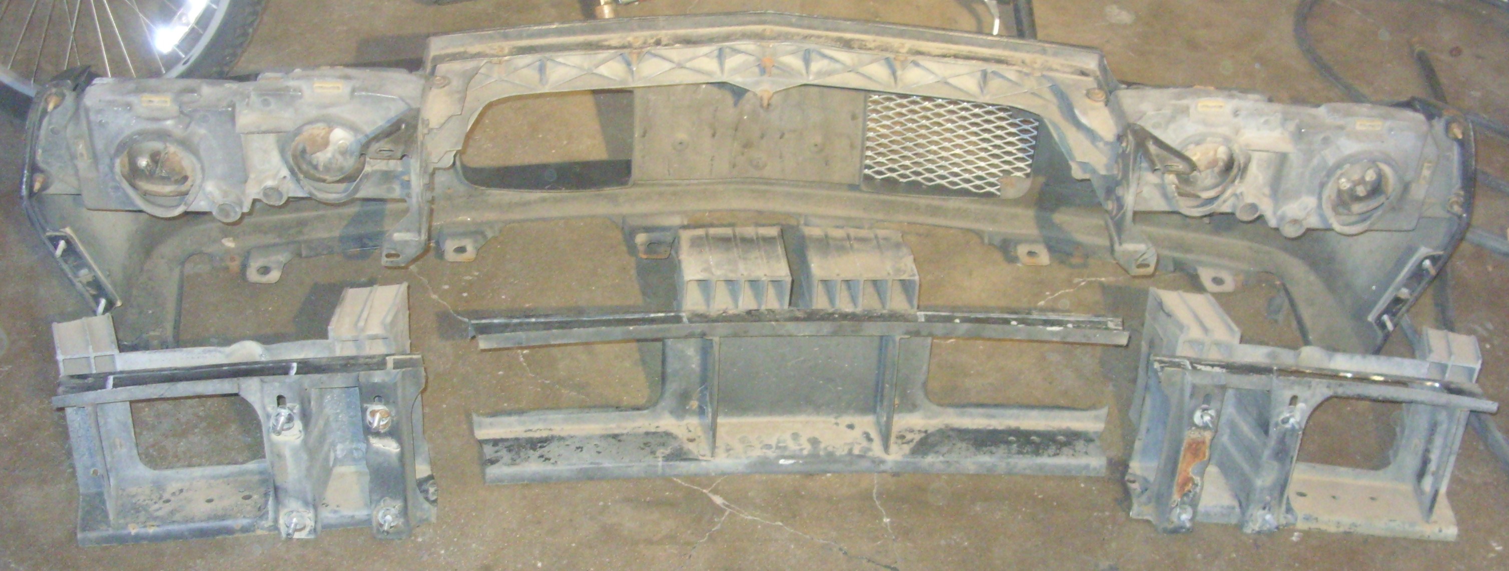

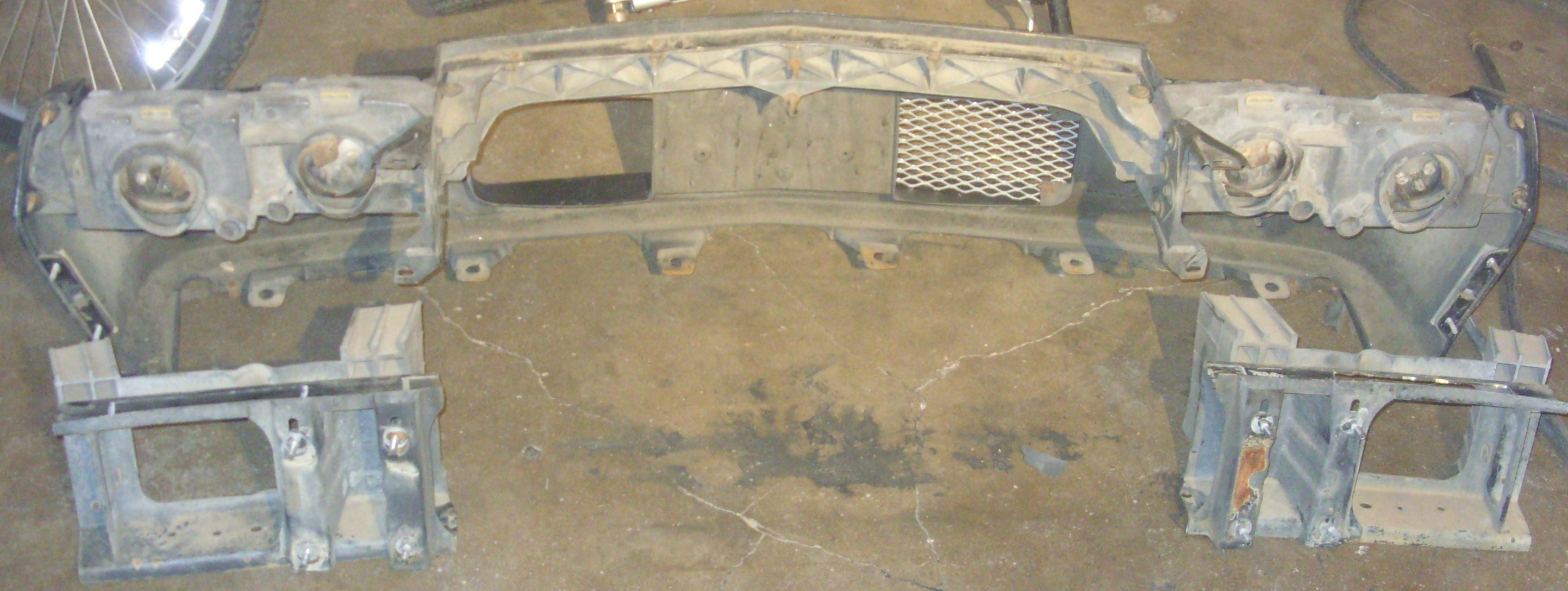

Removed the front bumper today and weighed it on a digital postal scale, 25lbs. I then cut the middle section out and fabbed a small center brace to hold the center of the nose in position. It now weighs 15lbs and was alot easier to reinstall. I also found a guy on ebay selling aluminum water pumps for our reverse rotation serpentine set-up cheap!!
http://cgi.ebay.com/ebaymotors/ws/eB...m=170560640341
Attached Thumbnails The Weight Reduction Thread!-031.jpg   The Weight Reduction Thread!-032.jpg

thats very similar to what i had planned when i change out to this aluminum unit.
id have left the mounting ears on it and cut to either side of that, but a few tabs and youll be set.

I'd personally never want to sacrifice a safety feature of the car for 10 pounds. You need 100 lbs off for a measily 1/10th in the 1/4, yet 10 HP added will net you this as well. I'd much rather add 10 HP than take my crash bar (reason it's called this!) off for weight savings on a street car none the less. Things I'd consider are a fiberglass hood, AC delete, lighter seats/removed seats, etc. I don't like changing the way the car was designed from the factory for good reasons! I say if it's not fast enough, add HP unless your building a dedicated race car.

I agree, that seems insane to cut anything from the car to save a little weight. Most on TGO would call that a hack job, I wont, I just dont think it is safe, couldnt you just change all the susspension parts to tube aluminum like the K member and stuff like that? At most I gutted the AC but then again it will be a DD. I want to save weight but there seems to be a fine line.

heres how i cut my crash bar. top pic is before, bottom pic is after

85Z28NOS - Maybe I'm missing something but I don't get the point of leaving the 2 ends of the crash bar?? They don't bolt to anything but the frame rails and don't support the nose at all. Why not just remove the entire bar?

I heard that it does support the nose of the car, but i don't have any way of verifying that but it makes sense tho..
