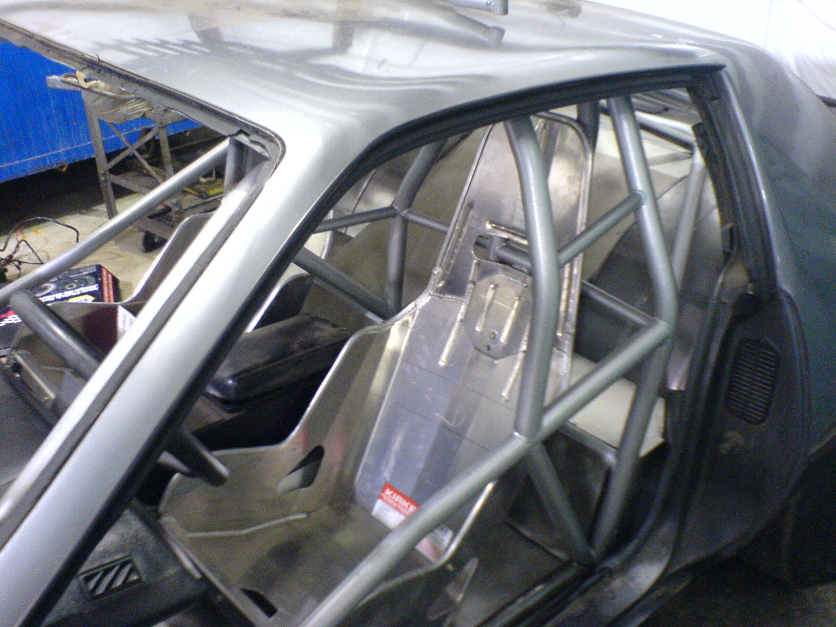

Here's weight loss for you. I don't know what this car weighs yet but I know I can grab the front end and curl it.
Attached Thumbnails The Weight Reduction Thread!-dsc00141.jpg   The Weight Reduction Thread!-dsc00139.jpg   The Weight Reduction Thread!-dsc00140.jpg

hey 1991 camarorslow...who's k-member are you using? looks good with the rack!!! you building a drag car or a road car? yea guys...weight is everything! any overall reduction we can make will make the car faster, more responsive, and generally a better driving vehicle!!!

That's a friends car, built by the former owner of Pro Fab, I have the exact K member but powder coated blue. It's built to be a street car and loooks absolutly insane. The car retains the torque arm style suspension (fully adjustable) and is trick from bumper to bumper. I'll get some more pictures as the car progresses. The owner plans to big block/powerglide combo it.

if possible try and get a pic of the front of the car from the side. that project looks extremely cool.

Is it my imagination or is that cage/chassis work MIG welded?

Appears to be...maybe this is a dumb question....but why shouldn't it be? I just did an 8pt cage in mine...it all is.

I believe it's a combination of mig and tig actually, I can ask next time I'm out there.

Hey, I have absolutely no problem with it, I seem to regularly get flack for being a big advocate of MIG welding _most_ things unless they are the kind of thing that HAS to be TIG welded to get acceptable detail or to deal with the materials being welded…
The reason that I ask is that I can for the life of me get a clear answer of what NHRA and IHRA rules are with chassis certified for 8.49 and faster. At one time I was under the impression that at that point you’re required to use 4130 and TIG (which I believe is more then a bit stupid and I’m fairly sure _used_ to be the case), but now I’m seeing chassis built for faster cars, especially 25.2 stuff that are MIG welded (and I’m assuming mild steel but rarely get a look at bare bars close enough to make a reasonably educated guess), and haven’t seen any clear definitions of what is legal and what is not.

Well, i dunno about NHRA rules...but IMCA only requires MIG, and that even goes for cars up to full blown sprint cars and outlaws (talkin dirt track here) But these cars are runnin 120+ in a circle, side by side. i know that really has no bearing on NHRA rules...but it's widely excepted in the dirt world to be simple mig welds.

If really concerned with weight some things i didn't see mentioned are.
get rid of the sound deadner, throw out the (rice) subs, amp. drop the stock gas tank, use a 5 gallon fuel cell. Install a smaller wiper motor.
and my favorite
Get rid of the seat rails. no one ever sits in the back, I custom welded fixed seat mounts out of alluminum. they weigh 4 onces each (1lb per seat) instead of 15+ lbs.

^ Oughta toss lightweight racing seat(s) onto the custom fixed mounts

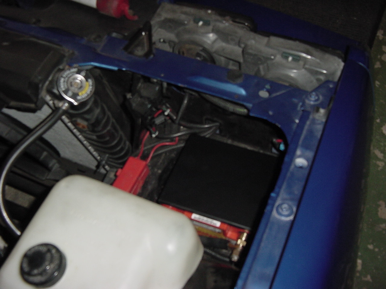

Lightweight Odyssey Battery
Just got done installing an Odyssey PC-680 battery. Old battery (AC Delco 75-7YR) and mtg bracket/bolt weighed 36.24 lbs. New battery weighed 14.38 lbs plus 1.11 lbs for the aluminum bracket (part# HDB 680) and bolts. Total weight loss 20.75 lbs right off the front of the car. I bought the PC-680MJT battery which comes with a metal jacket around it, which is useless because the jacket has to be removed to fit the battery inside the mounting bracket.
This thing fits perfect inside the battery tray. I had to bend the front lip on the battery tray with my BFH a little to move the battery forward. I also had to trim about 1/4" off of the inboard side of the bracket so it would drop down nice in the tray.
Attached Thumbnails The Weight Reduction Thread!-battery1.jpg   The Weight Reduction Thread!-battery2.jpg   The Weight Reduction Thread!-battery3.jpg

Wow thats a great weight savings. I may have to go with one of those batteries once my interstate dies. Good price + Warrantee and all the other features.
Tim, have you run the car with it? Does it start OK? I’ve had a PC-625 sitting around for over a year, which has something like 25-505cca (depending on conditions) less and weighs 3lbs less. I haven’t put it in anything but it will probably go in the “new” TA. I measured it out and it will completely fit under the lip of the core support behind the headlight, leaving the battery box for a bigger air box/intake plumbing (I don't want to have to run a cutout switch).
My brother has run a similar sized, plain old lead acid lawnmower battery for years now in his rear mounted battery box without any starting issues.

I drove it yesterday and it started up fine.
