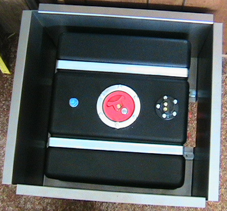

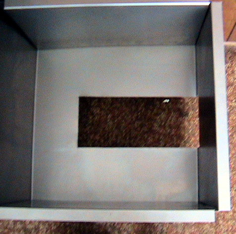

Well The Box is made I just have a Few things to do to it yet. I am including Pictures, Althought is seems that no one is interested
Pic 1

Pic2

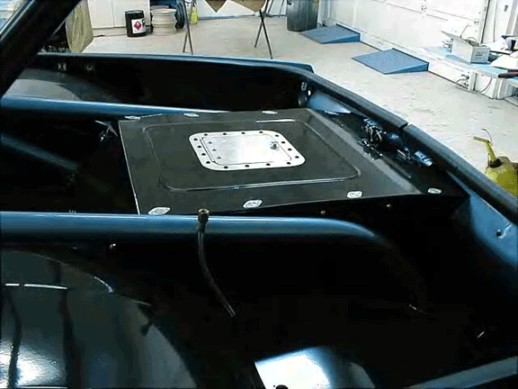

The Box is being mounted in the Rear where the Hatch Well is. I havent Finished the Lid Yet. It will have a Lid with a fuel access door Sorta like the pic I am including but Mine isn't tubed and will be flush mounted With the Floor the Runs to the back seat The Lid Will Bolt on so that If for any reason I need to remove the Fuel Cell I can But I will have a Fuel Resistant Silicone Used as a Gasket to make sure it is sealed. Remember My Box is similar but not quite as big as in the pic below, but Will be mounted totally different.

Actually I have a NHRA and IHRA Rule Book + I emailed several Tech Inspectors and they said the same as the Rule Books, The box must be mounted in at least .025 Sheet metal or .032 Aluminum and Be sealed from the inside of the car, But will alow for a 6"X6" Hinged Postitve locking Fuel Access Door. The tech inspectors said the the picture I included of the other car with a fuel would be Perfect as long as there was a Gasket or fuel resistant Selaer between the lid and the box, it had to have a vent line running Out side the box, and the access door was positive locking and the hole box was at least .025 Thick. and a Guard for the sump the same thickness. The rules say that you can leave a small opening for access to the Fittings. As long as everything meets the above cirteria you do not need a firewall, it is no different than the gas tank Being mounted under the floor as long as the box is sealed and vented properly you woun't notice a difference.

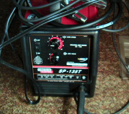

Well I am getting Close To the installition, I recivied my Lincoln Sp-135T Mig, SpeedGlas Helmet, and Welding Gas 75/25 yesterday. and for those interested in a Mig the Lincoln Sp-135T is only $395.00 from www.weldingsupply.com

The box is all welded up so I am going to link some pics, next sunday the install is taking place. I went to the Steel Shop and Purchased 10ft of 1"x1" .118" Square Tubing and 10Ft of 1"x2" .118" square Tubing. along with 7",10" and 4 1/2" Cut off Blades for the Chop Saw, Table saw, and Angle Grinder and baught some .030 Wire for the Mig, I think that should get me off to a good start.
