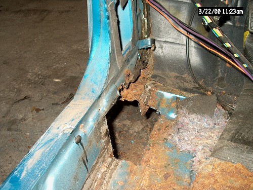

i posted a message before, heres a picture of my problem, how would you go about fixing this? i did a search before and found someone who did this exact thing but now i cant find it.
this hole goes outside behind the fender

a friend and i repaired that spot on a 91' rs once, it was much more gone then yours is, it was a real trick to get to, we ground all that we could out of there and ended up rebuilding the footrest and the side plate near the fender with sheetmetal cut and welded in place, now we need to pull the fender and cut and weld a patch in there as well to make it a complete fix.
be sure to make sure all the factory seam sealer is out, and take your time. i'm sure others will say different then me, but this car was made to be a driver and thats what its gona do.
i have pictures of it somewhere, if i find them i'll post them.

ok, heres the pictures from last year when we patched the 91 rs.
Before
after
welds sealed and painted
finished

yeah it's exactly like the above pictures, just not as bad i guess it's common for the 3rd gens, i need both sides cutout and welded up

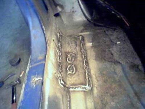

Same with mine but the outer,inner and floor were gone. I would not use silicone it might hold up fine but y chance it. And have to redo it. Get auto seam sealer.or the best would be a expoy seam sealer. I use sem stoff is great and fuser is good. And use a good weld thru primmer.
Attached Thumbnails rust inner rocker help!-c-documents-settings-owner
Old Mar 31, 2005 | 10:36 PM
jay92,85,79's Avatar
Joined: Apr 2004
Posts: 1,674
From: glenwood IL
Car: 85z28,
had to sign it lol
