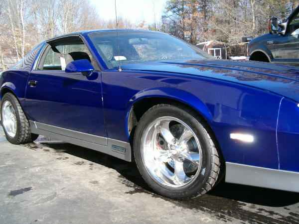

when i painted mine i sanded with 80 grit on a d/a. then two coats of omni epoxy primer. no need to sand before coats if done within the p sheet directions. after epoxy is when you will put on your highbuild 2k primer that will be the sandable coat that you will want to wet sand, if you need any filer put it on the epoxy without sanding the epoxy. the bond is great and the filler is protected.
now the fly in your plan.....primer does not protect the body from moisture. so if you planning on driving the car in primer you will have to strip the entire car again and do the primer over before paint. primer wil soak in moisture and pull it to the steel. not a good idea. if its sitting in a garage you can have it in primer for about forever.
if you want to see the steps i took search for "project resurection"
think there are 7 parts some were combined by the mods.
Wear the proper resipratory protection when sanding a good fiber mask made for it will protect you and when spraying use the proper mask or fresh air mask/hood. you only get one set of lungs.
take your time on the prep its the end result of the job if it sucks the paint will suck.
Jeff
Attached Thumbnails priming car-c-documents-settings-jeff
