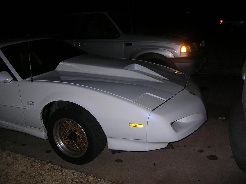

I installed my hood but am having fitting issues. As seen in the pic below the front part is sticking up a little. How do i fix this??
There are four rubber screw down bump stops on the front of the hood - lower them. You can also raise/lower the hood latch.
