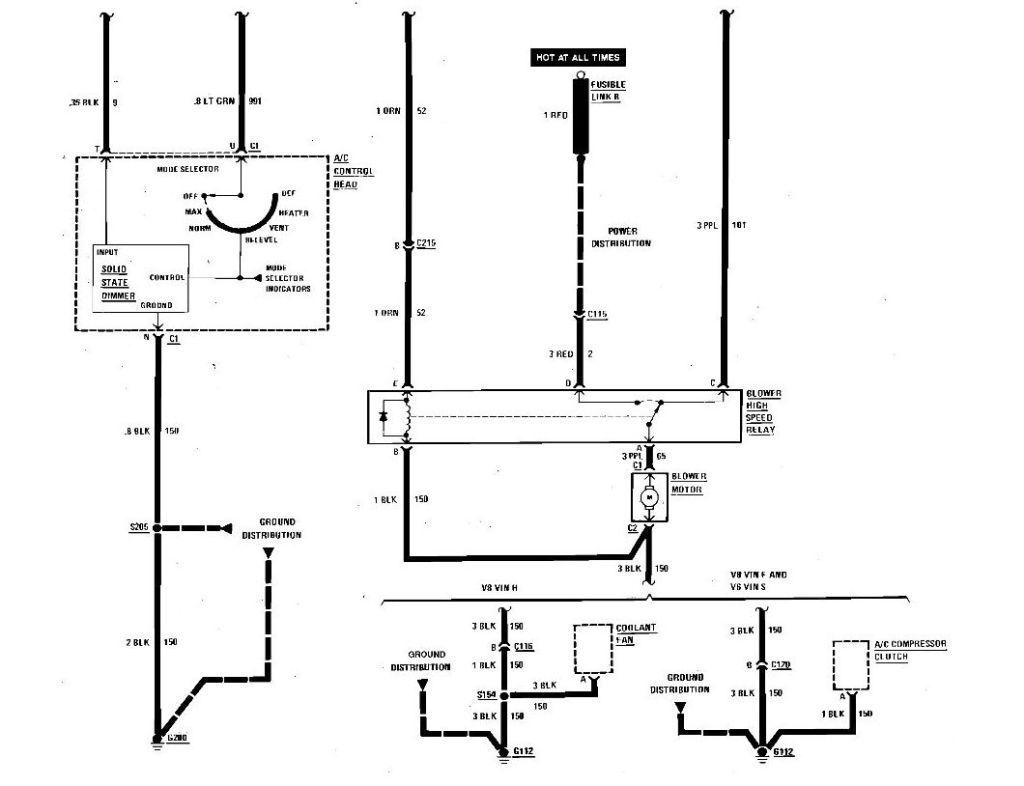

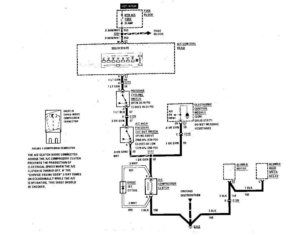

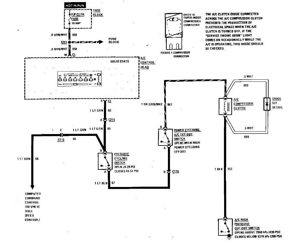

Here are a few diagrams for an 1988 Pontiac Firebird V8-305 5.0L VIN E TBI ... Hope they help....
41905739.gif?t=1262884570
41908541.gif?t=1262884570
41908542.gif?t=1262884571
41908543.gif?t=1262884573

Thank you very much for diagrams

You are the man!! I didnt think anyone would have them. This will be a big help.

oki, the diagrams yoiu have is good..
but I don't get the pinout to compare with my board!
some off the conections on your diagram have letter's, but my instrument have numbers on the big conector. the smal one have no markings.
So, can anyone tell what signal going in to this "digital" boad?

From what I could tell those diagrams were labeled as being for VIN "E" cars or TBI cars. I don't see how that helps given the fact that any car with a Digital Dash would be a VIN "F" or VIN "8" car with a TPI engine.

Re: wiring diagram for the digital dash....88 gta
Any chance does anybody have the wiring diagrams for the digital HVAC and climate control?
Old Mar 6, 2022 | 08:42 AM
Bill Hubbs's Avatar
Joined: Mar 2021
Posts: 6
Here are the wiring diagrams for a 1986 Pontiac Firebird electronic HVAC.
Blower Control 1
Blower Control 2
Compressor Control FI
Compressor Control Carb
Air Delivery 1
Air Delivery 2
Old Mar 6, 2022 | 08:59 AM
