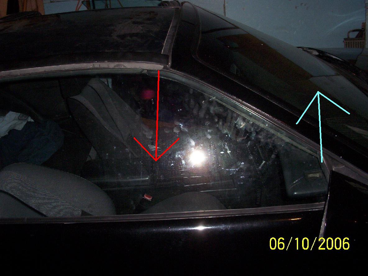

Alright, I tried and tried. I'm not window master but I know where all the adjustments are. Please help me get this windows straight before I make it doorless.
I need the front of the window to go up, so rain won't come in. I need the middle of the door to go down, so that it won't contact the t-top weatherstripping (which then keeps the window outward half an inch )

My problems is that the rear upward stop is hit before the window makes it to the front upward stop. The motor won't push the glass any higher in the front.

I had a smiliar problem after I replace the motor. It ended up being that I put a metal slider on backwards. It's about 6 inches long and in the middle of the door. It can mount two ways.

There is a small adjustment channel(about 6in in long) right above the arm rest support brace.Just lossen the two 10mm bolts.Move the rear bolt up/down this will tilt your window up/down.Keep the window close to the top so you can monitor your gap.The stops wont change the tilting you have they will only prevent the window from going up too far or not far enough.......BTW if your window is too far inward or out.You can adjust this by lossening the 2 bolts(the 2 just inside the door facing down) on the rear channel(the one with the rear stop on it).Moving the bracket in/out will pivot the window in/out at the top.The other 2 bolts on that same channel(the 2 you can see on the door frame facing you) moving these back/forth will adjust the window forward/backwards.
I had always skipped these two bolts in the hours of adjusting, however I stumbled across them yesterday and like magic, the door is almost perfect. It even change other gaps that were marginal to good.
All I need is a little more fine tune adjustments to make the front of the window hug the weatherstripping and I'll be done .
