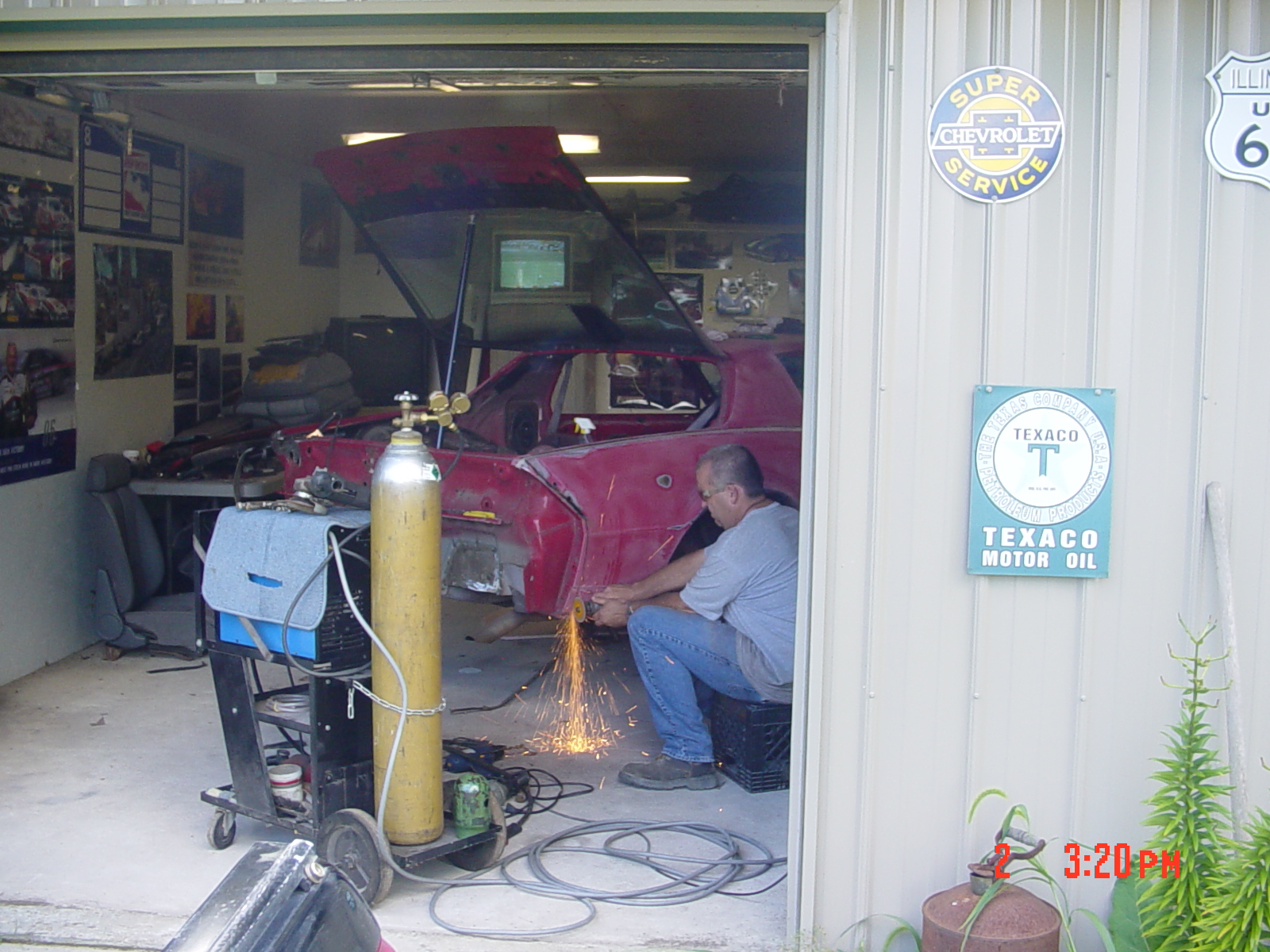

Looking back, I wish I had taken more pics of this one so you could see how it was done. I'm no pro, but I've done over a dozen of em.
In essence, here goes:
I got this particular panel from "The Parts Place" in Elburn Il for 89.00.
The panel comes just about the size you see the cut out portion on the car.
Naturally you want to weld/cut on the flattest/narrowest area possible to avoid using too much filler.
I went 1 inch in from the door jamb and 1 inch up from the rocker. No sense in messing up a perfectly good fitting door jamb. On the top I went as high as the patch allowed across the sail panel area and then right down the middle of the top of the quarter being that it is a nice flat area to work with.
The back wraps around in the original position.
I trimmed the panel to the exact size I desired first, then placed it on the old quarter and taped the outline of it with 1" tape. I always BUTT the panels as once you undercoat the inside of a trunk area it's impossible to see a seam.
Once you've double checked every thing, it's just a matter of taking the trusty die grinder and start buzzing off the old quarter. Use the thinnest wheel you can find as it speeds things up considerably. Plasma cutters are great, but I don't have one.
The hardest part is the area in back where it wraps around. Scrape the putty away & grind down just far enough to break the factory spot welds and it will peel right off. The same goes for around the wheelwell itself.
After that it's just a matter trial fitting the panel and trimming any problem areas. If your inner wheel well is trash it's quite a bit more complicated than this but mine was useable. ( though I did try to find an aftermarket one to no avail)
Once you've got it clamped in place, tack it in a couple of places to hold.
My brother does all my welding for me so I can't give you the specifics on the settings he used but it was a wire feed unit. He went about every 4" initially alternating between different ends of the panel to prevent warpage. TAKE YOUR TIME ON THIS AS IT MAKES OR BREAKS THE WHOLE JOB!
When done we had one little warp in the sail panel area which was easily pounded out from the speaker area.
After welding, grind the welds flush with the panels and fill as needed with a quality filler. 90% of what is shown in the pic was sanded off. you should have no more than 1/16" or less of filler in any spot.
As I said, I'm no pro & lots of people will disagree or have different ways of doing it but then that's why were all here, right!
BTW, I've never had an aftermarket panel dent due to someone leaning on it, pushing or whatever. No one should be that close to your car anyway!
I'm starting the paint on mine in a few weeks and will post pics when done .

I ground all the spot welds around the wheel well and where it wraps around the back with a die grinder.
I did not have any overlaps, butt welds are the only way to go.
As I said, I cut mine 1" away from the door jamb, try not to go in there if at all possible!
Look at the pics closely, you can see where I did the top edge.
