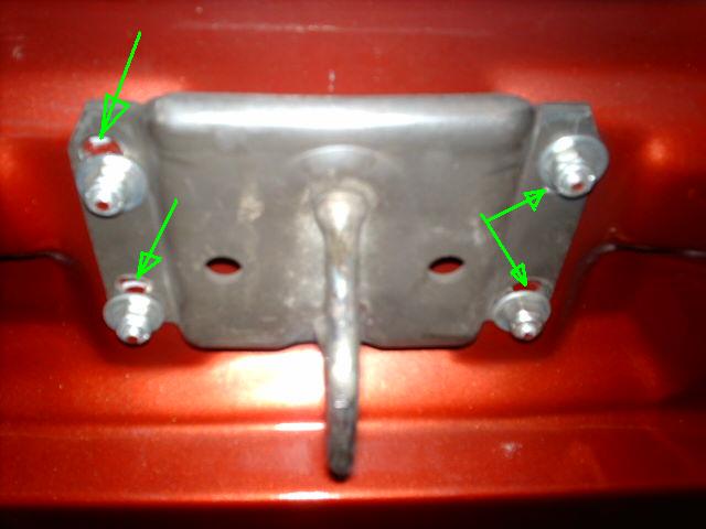

Some member have asked me questions of how the shocks are installed on the Hawks notchback so here they are.
Some modifications where done to the latch as seen in the pictures. The shocks mount directly into the bolts supplied on the notchback (something I really dont like much, bolts moves!!) And also I had the mounting holes enlarged in order to have notchback nicely between the lines of the rear end. The holes where then filled with epoxy and sanded.
One important thing, stock shocks are to powerfull!!! The much lighter notchback 45lbs vs the 135lbs stock rear window plus T/A aero spoiler, need weaker shocks or some old shocks. What I did is that I traded my almost new rear shocks for some old ones from a friend of mine and voila!! He ended having his hatch opning again and mine opened nice and easy instead of launching like a rocket.
Hope this helps,
Edgardo

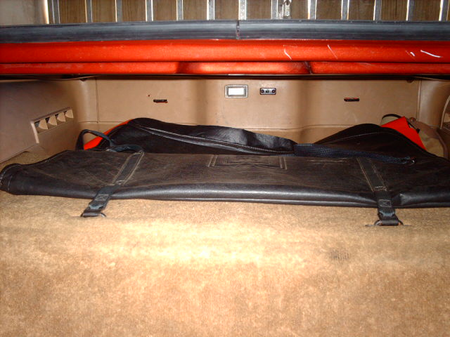

More pics

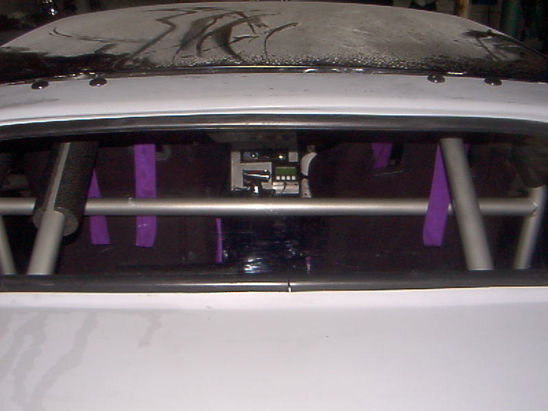

Here are some pics of the notchback with rollcage from another member, and yes there is room for the t-tops, about 6-7 inches. Heck, I will measure it right now.
Attached Thumbnails Notchback-hawks-notchback-1.jpg   Notchback-hawks-notchback-2.jpg   Notchback-hawks-notchback-6.jpg

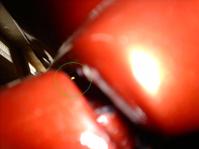

Here is picture of the gap that I am talking about. The camera does not make justice, the gap is big. I also noticed that the gap is apparently in just one side, driver's. I also took a picture of the adjusting method for the hatch, which I took just now in an attempt to lower the hatch. If I lower it more I have to smash the hatch so hard in order to close that something might break.
Attached Thumbnails Notchback-notchback-gap.jpg   Notchback-notchback2.jpg   Notchback-notchback2-4-.jpg
