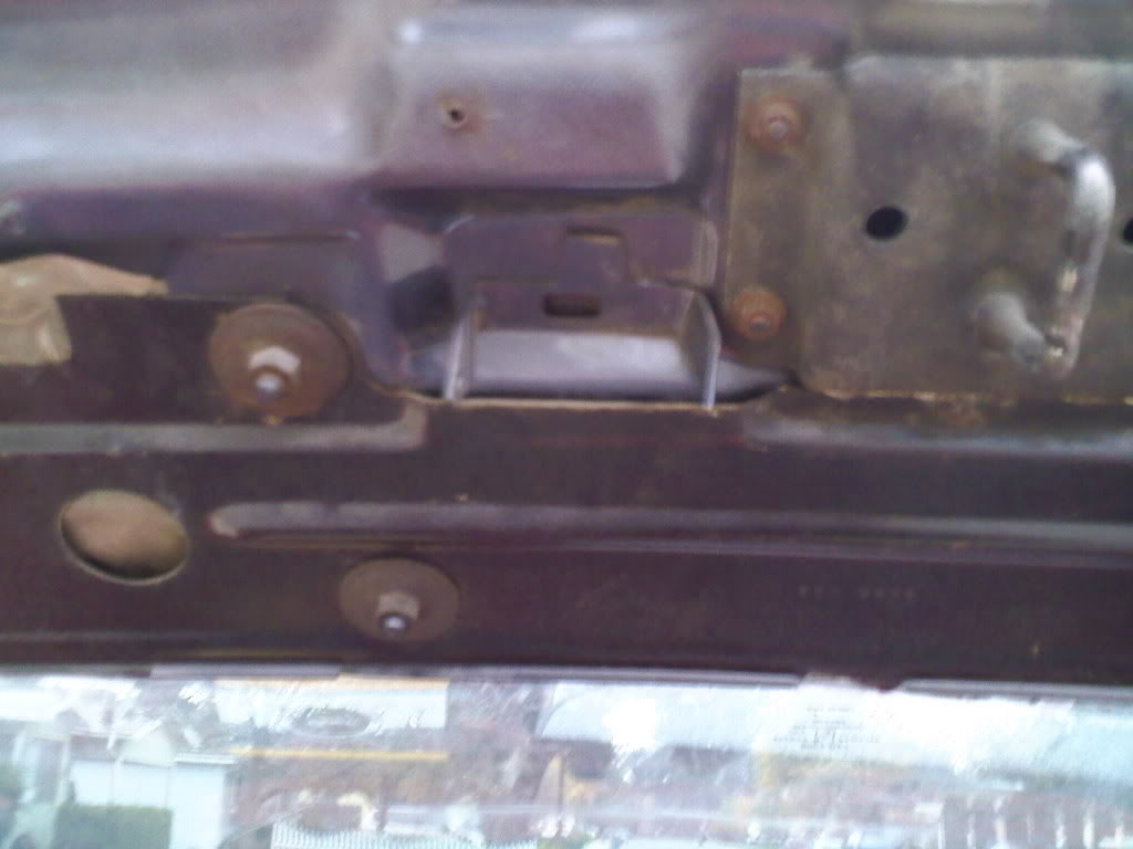

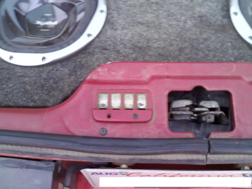

Re: HATCH PULL DOWN UNIT PROBS!!

No, i bought a new complete rebuild pre assembled unit. i installed it and it worked properlly, yes my two contacts are there and touching. checked the fuses. checked wireing. there is a ground wire and blue wire with a plug is only wires i have plugged in. there is another white wire which i had no where to hook it to, it was never used correct? I mean it was catching and pulling down correctly then just i poped it and it opened but when i latched it back it wouldnt pull down. Then i checked wires and took my ground a loose and reconnected it and it went down....? As of now ive tried nothing and its locked and stuck at its top position.

On the left of the hatch on the panel there is a metal contact, wana make sure your latch lid has two fingers that come down and touch this, this tells it to open when you push the release.
Wrong. The contact pad powers the HMSL (high-mount stop light). It has nothing whatsoever to do with the pull-down unit.

Hmm i dont have a HMSL, figured it was a ground of some sort.

haha yea rough i looked at your pic and ur two contacts your are talking about look as if ur black pieace wit contacts are missin ha, looks like you just have two little metal fingers there to just make connection ha. what is HMSL?
