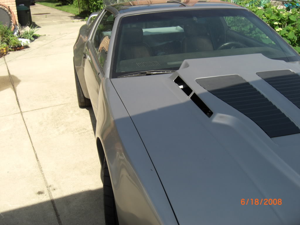

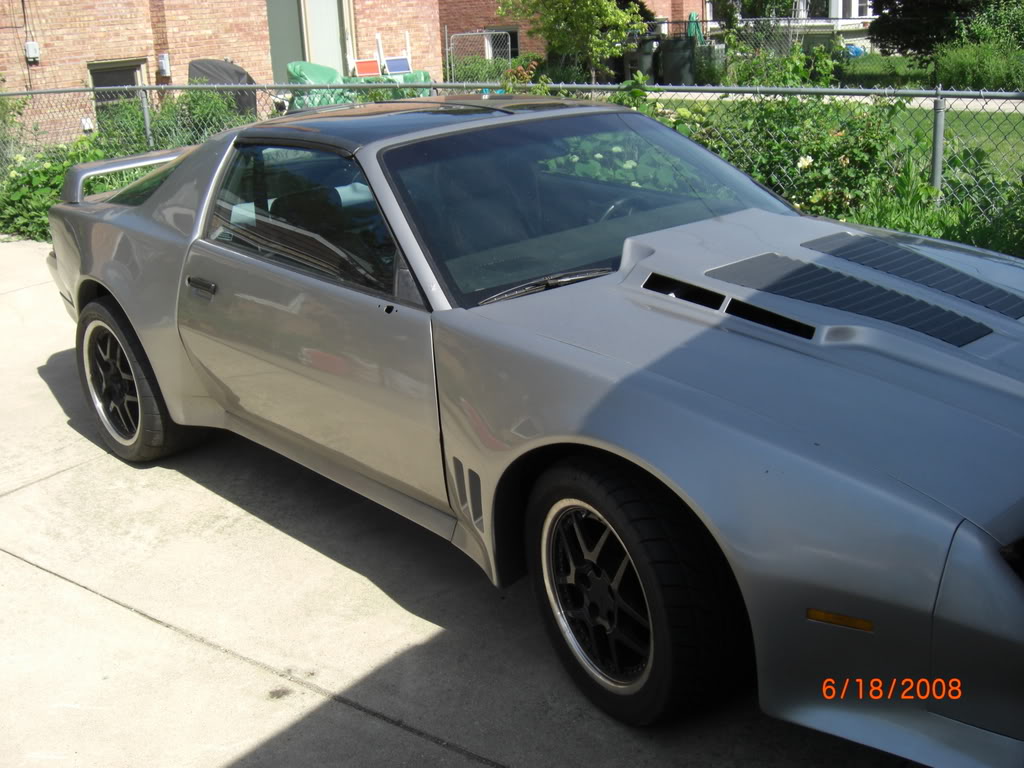

I love it, bad *** car, bad *** motor, PVC intake...ha ha, even the expensive find cheap alternatives.
Really though, nice freaking car. I would love to have that wide body kit. Mm Mm Good!

89ls1rs that car is very nice
nothing i can think of to make it look any better
don't mean to change subjects, but i would love to see how a GM notchback combined with that bodykit looks
