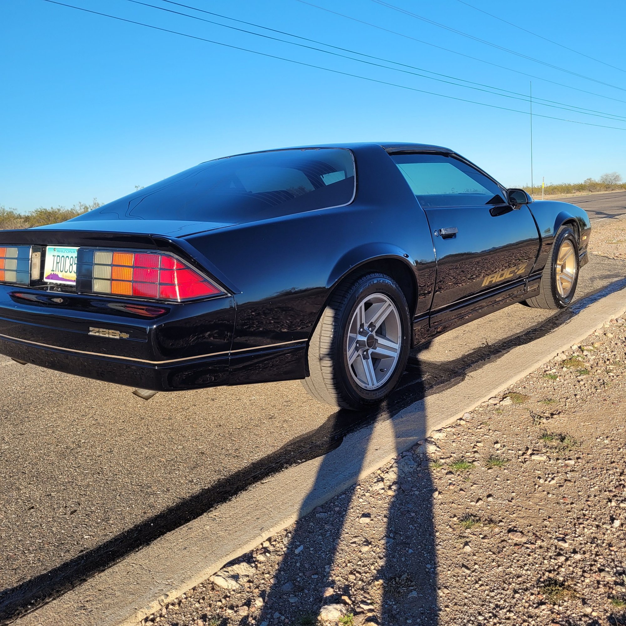

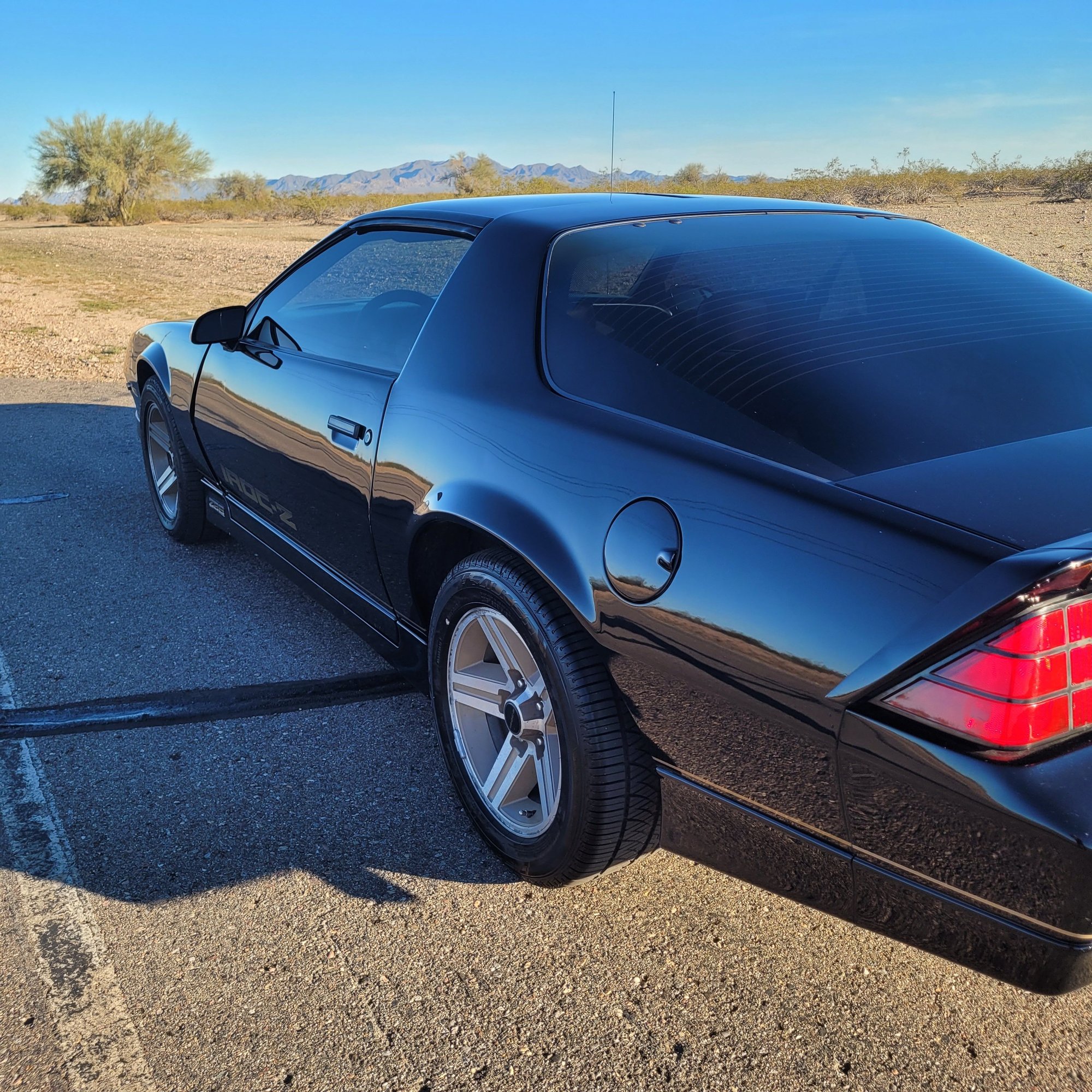

My 1985 Camaro seems to have the same type of gaps. I've only had the car a couple of months. I really didn't notice because the gap is exactly the same on both sides. I attached some pics to show the gap I am talking about. I am getting the feeling there was some body work done at some point. Does this look like it was a botched job?
Try look under the fender where the bottom bolt bolts to the car.
I'm willing to bet it's folded voer, as someone probably but the car on a hoist there or jackstands.... if that happens, the fenders get pushed out.
Straightening that out can help push the fender back in place
That's great info. I'll check it. Thanks!
