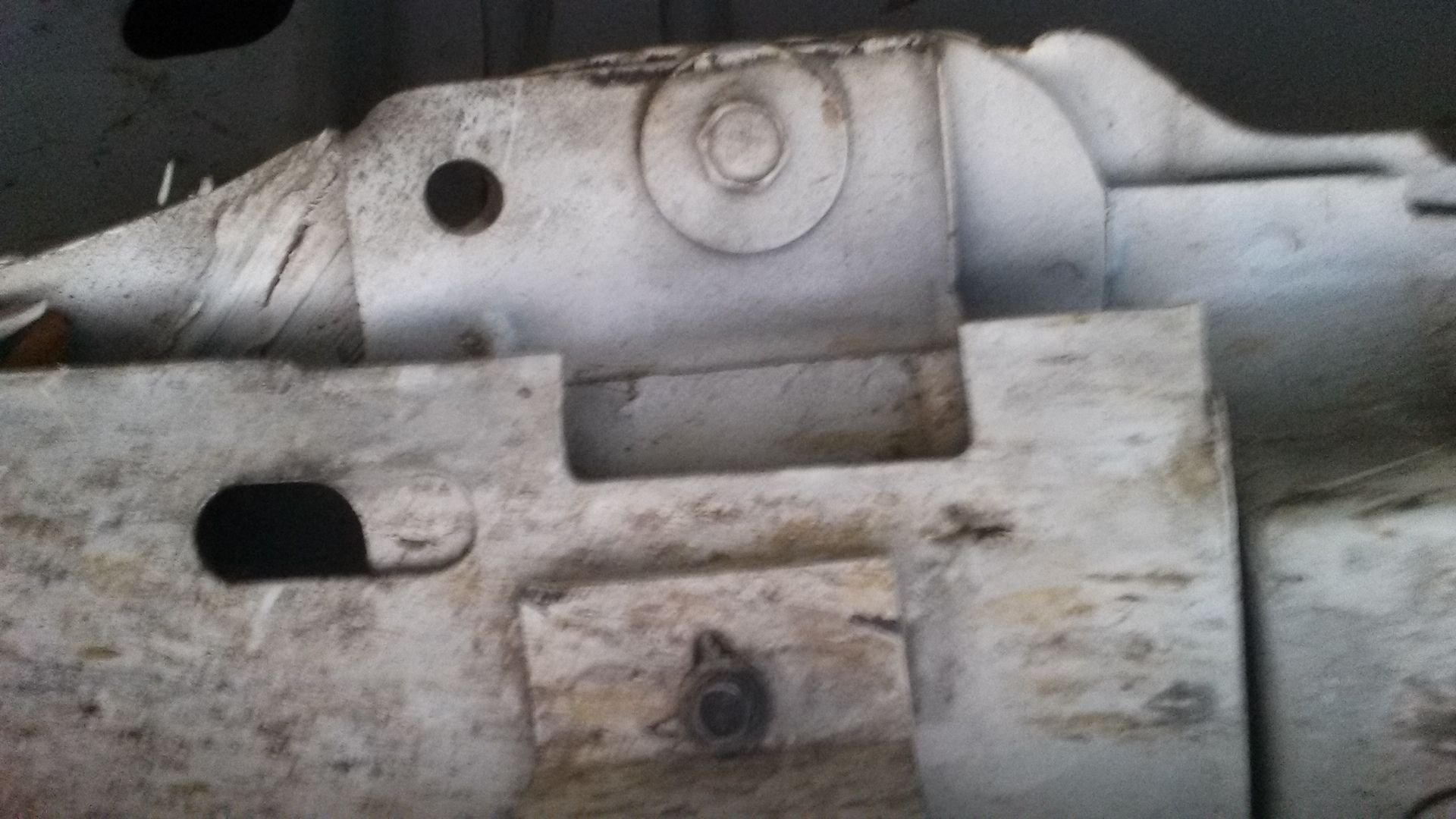

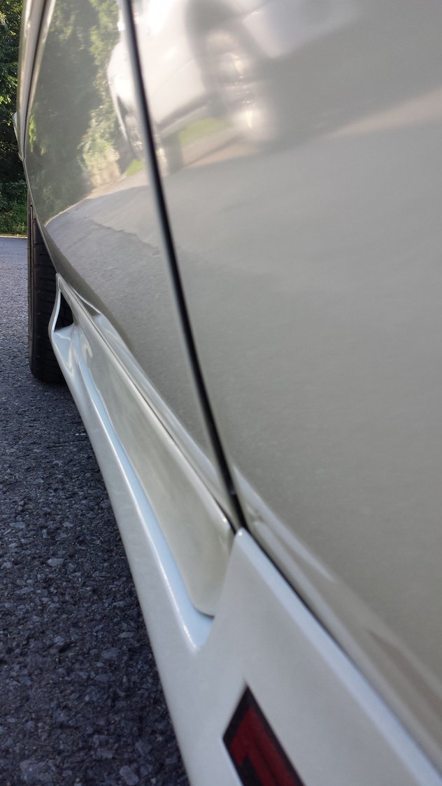

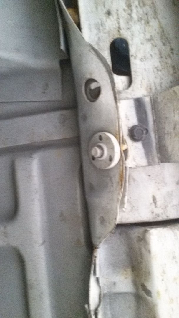

Here's some pics
This was as close to perfect as you can get before these D*ckheads f*cked her up!
Passenger side
And driver's side
Old Jul 25, 2019 | 10:29 PM

It sucks that they did that, but a lot of 3rd gens have those tabs bent by improper jacking. Can I save you 670 bucks? Put duct tape on those tabs to protect the paint and get one or two vice-grips and bend them back. That's what the body shop is going to do.

I appreciate it. The fender on my passenger side got bent inward on the bottom. Plus I really need the insurance to go after the shop for their money. It's good news for that shop manager I'm a god fearing man!
2-minute repair - BOTH SIDES - using a 2 large adjustable wrenches,.... Put a towel over the wrenches before starting if you don't want to scratch the paint.
$670 of body work? LOL.
$300 up on the lift,.... $300 down off the lift,.... $76 dollars to use the 2 wrenches for 2 minutes !

I understand but my passenger side fender on the bottom got sucked inward. It was flush with the door with a nice even gap and now it isn't.

Sometimes the fender re-aligns when you fix the tab.

Can you really bend the tab back with elbow grease? I mean the weight of the car bent it... Just curious...
I’d say it’s worth a try... It’s already messed up... if it doesn’t get fixed take it to the shop...
You can, indeed.

just bend them back,if you can adjust an adjustable wrench or reposition the jaws on channel locks you are golden.
i just did this last weekend on a parts car that i removed the fenders from.irony is BOTH TABS WERE FOLDED OVER
i wouldn't even waste my breath explaining this to the idiot who did it,its a 5 minute job.
if you think the fender is pulled in,remove the bolt from this connection ,straighten the tab.
then gently pull out the fender at the bottom and straighten the fenders tab as well when satisfied then
put the bolt back in.
get used to working on your cars,it offers an immense personal pleasure
knowing you can do something the average mechanic would fail at miserably.

If the fender won't re-align completely, loosen the bolt on the tab, have a buddy push on the fender while you tighten the bolt. Voila!

agreed,it really isnt hard....It does take more than just bending the pinchweld back though .this car is insanely low miles though(4000? really,wow).i wouldn't let a soul touch this if it was mine.

Just get a vice grip, straighten it out yourself and call it a day. The fender usually straightens out when the tab is bent back. When I had new tires put on my TTA, I brought just the rims, and then I watched the guy dismount and mount them. Don't let them jack up your car or put it on a lift.

straightening the piece of metal they stupidly and incorrectly destroy by refusing to properly lift these cars doesn't magically make the fenders pop back out,the idea of that is ridiculous and kind of outlandish tbh.why would you think straightening the pinch weld would fix the bowed fenders?you need to pull the entire thing back into position undo then reconnect the fender bolt at the bottom and possibly straighten the bow of the fender out.it definitely is not as simple or effective as you suggest.
at the bare minimum you need two people TO PROPERLY REALIGN THE FENDER

When you bend the pinch weld back, the fender will move back into position. I have done mine. And it went back. If it doesn't go totally back, loosen 1 bolt, reposition and done. 2 People? lol

I gave this post a thumbs up because yes indeed I have done this repair several times on various third gens over the years that had been improperly lifted , and despite 1986BANDIT's protestations , YES IT DOES pull the fender back in line with the door .
PS , a visegrip with the wide clamping jaws does a great job of straightening out the very bottom of the pinch weld where it gets wavy from being crushed , after a regular visegrip has been used to bend it back into the proper position .

I like using an adjustable wrench. Vise Grip or Plier jaws can rip up the paint. Smooth jaws of a wrench won't.

think carefully...your damage was obviously insignificant so bending it back did something,i bent mine back and it did absolutely nothing.
the 3-4 other cars with this issue that ive worked on and tried to repair,DID NOTHING without doing more than bending it back.
the reason i mentioned this is because that's what it requires to be corrected,different scenario.
if the position of the sheet-metal is displaced and pushed upward the fender will still be bowed out even if the pinch weld is straightened out
if your pinch weld seam is a little bent your idea will probably/maybe/possibly work,unfortunately that isn't the same for everyone,is it?
