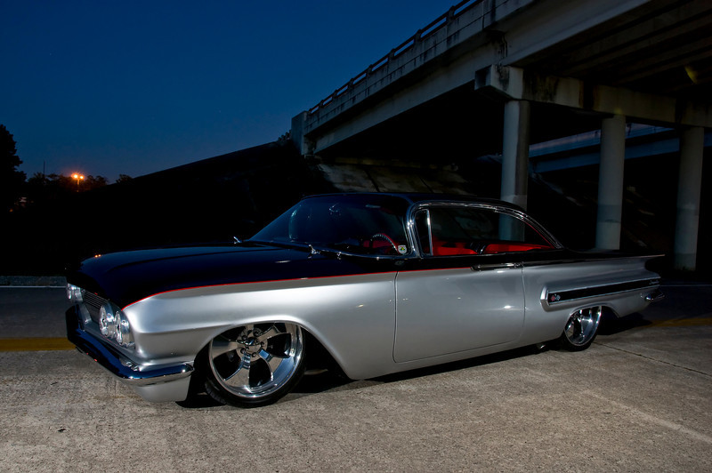

You should read and look at the picture in the post I made before that one. Then you would be even more impressed.
