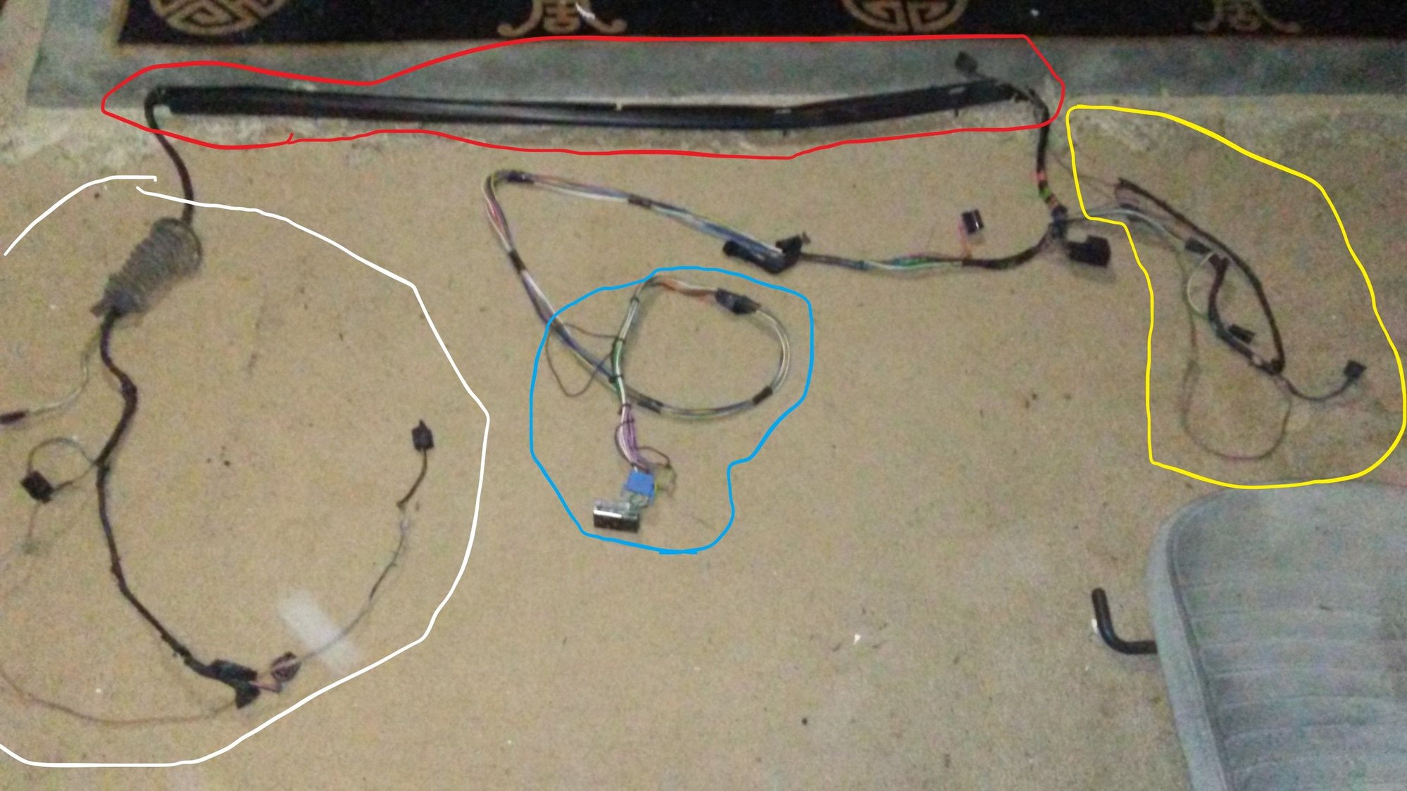

How far do the wires go under the dash?
The power door wires connect to the fuse panel and run the length of the dash to the other side of the car, then the switch portion turns and runs back along the dash wiring harness down into the switches in the console.
The white circle is the passenger door
Red is clipped to the inside of the cowl
Yellow is driver door
Blue runs into center console. Power mirror and window controls
