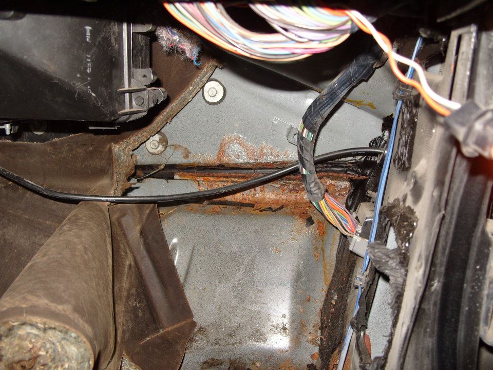

I was out today fixing some paint bubbles and some rust/rot in my left wheel. The rust/rot extended on down into the bottom front of the wheel well and when I poked my head under my car, I found that the entire driver side floor pan is about ready to fall out. The metal is ruptured in several places and barely attached to the along the pinch weld area. Not a spot of rust on the passenger side pan however.
Other than the floor pan being bad, I have a serious issue. I live in an apartment complex and have no tools with which to fix this. I can afford to buy a new pan, but I have no idea how much it will cost have the old one cut out and replaced. I live in Ft Wayne, and have family in Lafayette so if anyone knows of a body shop that can do it, send me their info. Also, if anyone has an idea of how much this will cost, let me know.

probably like 3 hundred just in labor. a little less less if you take out the interior before dropping it off.

Sorry to say it will not be cheap, you are looking at about 6 to 8 hours of labor, sheet metal labor is about $35-45 per hour. You really do need to pull the interior and take it to them to save money. The next problem is you need a replacement pan either aftermarket or from a donar car. If you don't provide this you will be looking at additional time for fabrication, and you need a good metal guy or it will look like a patch job.

I knew it wasn't going to be cheap. I can buy a brand new pan (read, its a freshly made one whose age is measured in months, not years) from Hawks for $300 (getting a quote on shipping). Stripping the interior is a non-option, I don't have space for any in of it a 500sf apt, the experience to do it without causing myself more trouble, nor a means of getting the car to a shop without driving.
So, $2000 for a pan replacement sound about right? Thats fine with me, I can live with that on my credit card for a while.

would be more like a grand to $1500, maybe hitting 2 grand on the higher side, depending on the shops labor rate. taking the interior out is a couple of hours work, then about 6-8 hours work on fitting and welding, then another couple hours putting the interior back in. so say 12-14 hours at anywhere from $40 to $80 an hour, plus the cost of the actual pan. id replace the whole floor pan whle youre at it. wont be much difference in cost between half a pan and a full pan installed.

I'm in need of the full pan, so not a problem there. I know it sounds like I'm just throwing money at this and not taking responsibility for this. However, I graduated college in May and started my job in August (had a very bad summer job hunting) and planned my post graduation budget around paying off my 6yrs of college in only 5yrs then start to work on my car. Rust it seems, has a plan of its own.
So, I'll need to delay slamming out student loan payments until I get this fixed. It's far cheaper to fix the floor pan than it is to buy even a decent used car.

Just replaced the driver side floor pan in my 91 vert. This is not an easy fix, you are probably gonna run into more rot issues in the front subframe, like I did. I ended up pulling the trans out so I could get in to fix the subframe properly.Just be prepared for more than just the floor pan itself. I have my own body shop and I cant say what shops in Indiana. would charge, just make sure they are a reputible company. Back yard body shops can total wreck your car if they don't know what they are doing with this type of repair..just my 2 cents

I managed to get only two shops to commit to giving a quote on this. Also, found out a friend of mine has done tons of interior work in his thirdgen, so I now have a place strip my interior and get it put back in.
The first shop quoted me $1700 labor & work on the drivers side rocker to replace only the driver side pan plus patch the hole in the wheel well. This is with me supplying the pan ($465) and stripping out the interior. Throw in the cost of renting a car for the week ($250) and it comes out to $2415 just to replace the drivers side pan. No under coating, no paint, no rust preventative, just labor & misc. materials.
The second shop I just came from found out that the 3 little holes on the passenger pan are actually all the way through the pan and have about a year left on the pan. The good news is both rockers are in fairly good shape, and if not he can replace both rockers while hes in there . He quoted me $1300 labor to replace both pans and do the undercoating so they won't rust again plus patching the rear wheel well. He also quoted me $250 labor & materials per rocker to replace them if they need to be replaced. He's fairly certain they don't need to be replaced, but he let me know just in case. I'm supplying both pans ($930) and stripping out the interior. Throw in car rental for two weeks ($500) and it comes out to $2750. If both rockers need to be replaced, its $3250.
I need to do some more thinking, but it looks like shop 2 is the answer.

*UPDATE*
Here are the pics of todays efforts.
Part 1
Attached Thumbnails How much to replace a floor pan???-driverside-firewall.jpg   How much to replace a floor pan???-driverside-floor-pan.jpg   How much to replace a floor pan???-driverside-overall.jpg

Thoughts, opinions? My friends and I are of the opinion that it is very much worth saving. And my friends thridgen both were far worse than this when they started on their repairs.

Absolutely worth saving. Although, the view from the top can be a bit misleading. Best to have a look underneath. BTW, ALWAYS be prepared for rust surprises.

This is the first time I've seen it from inside the car. The esitmate & my inital thoughts on this project were all based on what we saw from the outside under the car.

How bad does the bottom look?

Exactly as stated in my original post. The passenger side for all intents & purposes looks from the outside as if it needs only a few patches & touch ups. The driverside from the outside looks like its ready to fall out though.

Can you put it up on stands and get a decent pic of it?

Move the wire harnes ouy of the way and take a pic from around the trns tunnel close up on that rocker area. looks like the that plastic wire harnes is covering up the rotted area

That wire harnes that runs along the drivers side door sill, Can you move that out of the way

I can, will do that tomorrow though as it is pitch black out right now(These pictures are from 3pm today and I have laid the carpet back in as I neither want to go deaf or see the road go by while driving). But I can see & feel that harness THROUGH where the pinch weld should be from outside under the car.

I just want to see that edge, you can still have a good metal fabricator fix this with out replacing your entire floor. Take it back to the shop and let them look at it again

Well, no pics today as the camera is apparently taking the day off. I pulled up the harness and going from front to back, there is metal with rust on it & seam sealer until you get back to just in front of the seat belt mount. From that point back to where the pan starts to turn up to the back seat is open through the pan wide enough I can fit my hand into the gap.
Old Nov 20, 2011 | 08:18 PM

Just heard back from the shop. I sent them these pics last night and he didn't see anything he wasn't expecting and said that all of what he saw is repairable. Going to make some calls tomorrow and pic his brain on the passenger pan as that might just be within me and my friends tools to repair ourselves.
I'm just about ready to pull the trigger on this.
