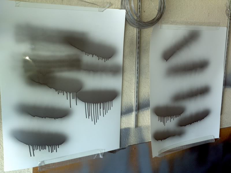

really depends on your gun, but it's usually around 25-30 with the trigger pulled
there are lots of links for setting up a gun, but here's the basics...
you want a 10" cigar pattern, and spray a horizontal test spray without moving the gun. hold it until it runs. adjust you pattern until it drips evenly for the entire pattern, if it drips from the middle first, or from the ends, DO NOT SPRAY on the car until you get that tweaked
here's a photo of me testing my gun

that paint I sprayed in the picture was urethane basecoat. the time I used rustoleum I was just spraying a plastic grill. I would never use it on an entire car.
as for the pattern, I probably was happy with the one on the left posterboard, but on the lower right side of the board
reduce it properly, and stir it, and the consistency will take care of itself
