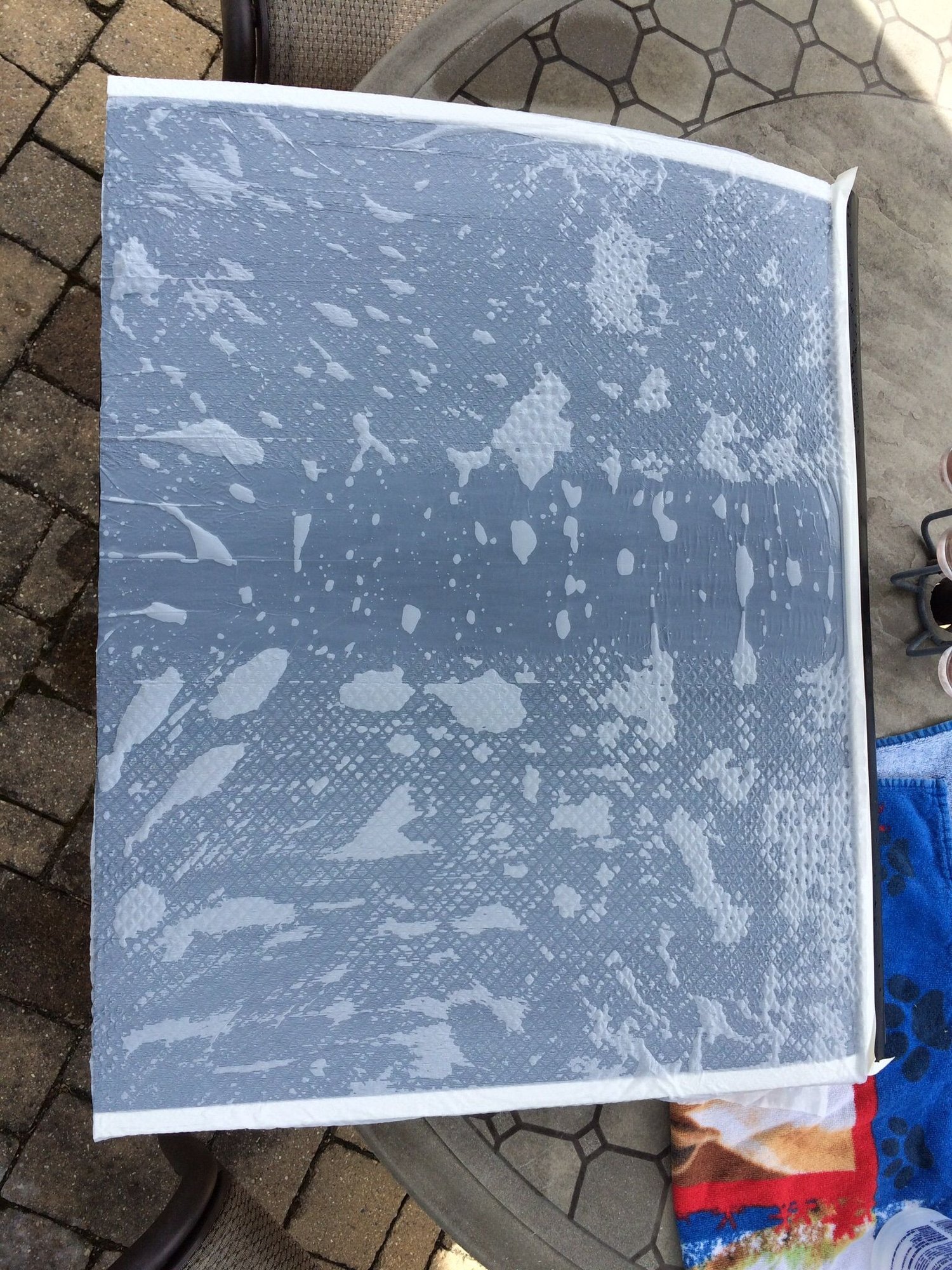

I wet sanded them with 220 on a 3-1/2" x 6-1/2" Orbital Air Sander...
Still lots of pits and deep scratches left...

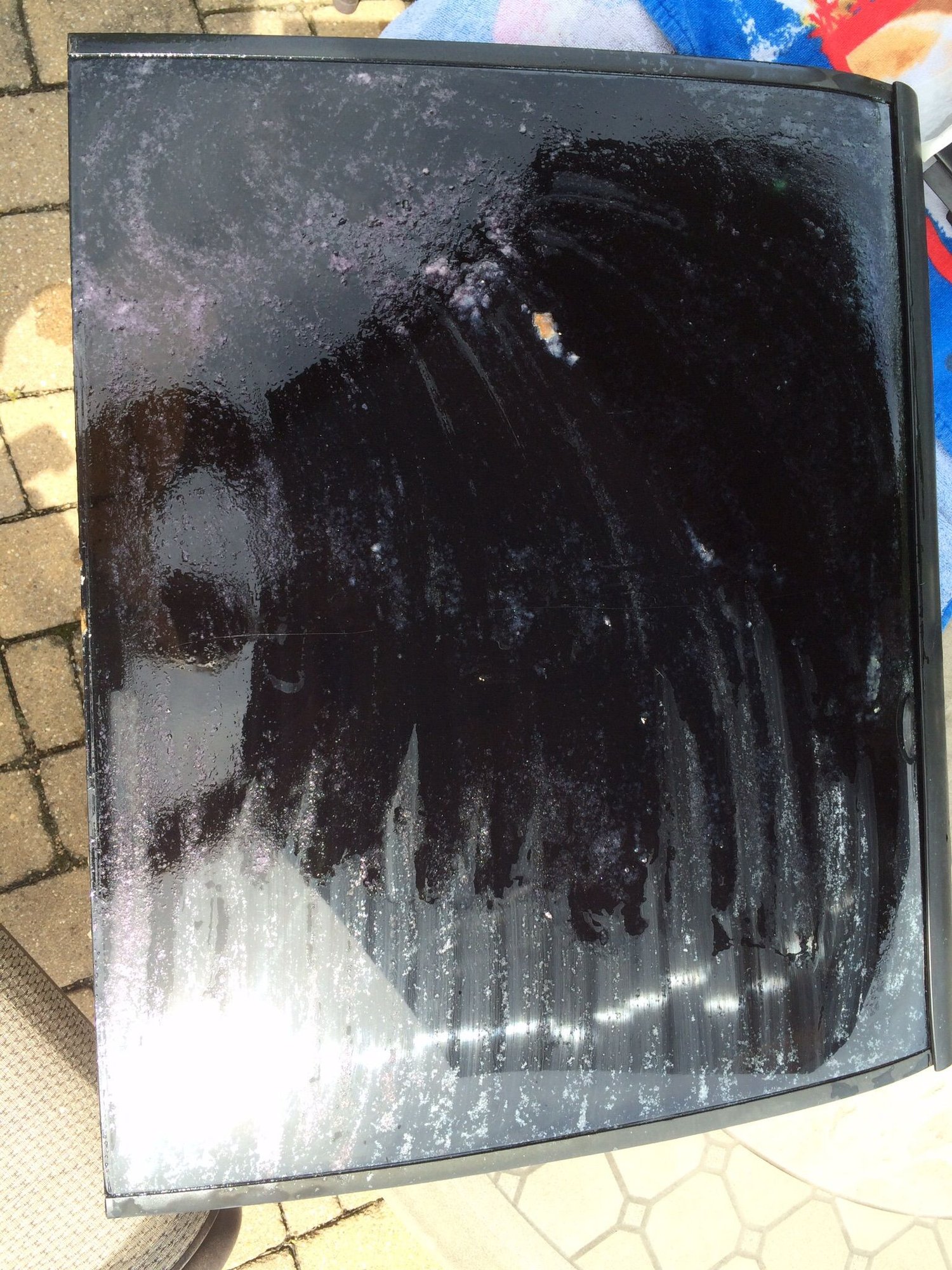

I come up with my very own compound for filling the pits and scratches... now to see if it works after i wet sand and if it can hold up to flex...
You can see one sanded and one still with fill...
Both sanded with 400 wet...

The fill has held up to sanding and flex...
So we'll fast forward... next steps in wet sanding after 220 and 400 where 600, 800, 1000, 1500 and 2000 to get them to this point im sure i could have skipped a few but it seem to take less time going up in 200 grit increments...
Here's a shot after 2000 grit

To bring an old post back from the dead. . . I've been playing with an old set of lexan T's that had been badly scratched. Tried a window tint removal trick to break down the anti scratch coat.
Goes like this:
Spray entire top with straight ammonia. Be careful to not inhale the ammonia, it's nasty!
Cover the top with a plastic trash bag. I left mine in the shade, but I bet in the sun would go quicker.
Let sit for some time, I think mine were "soaking" for over an hour.
Pull back the trash bag and the clear coat should be all loose and wrinkly.
Then use a plastic scraper and get most of the clear coat off.
Now that most of the clear is gone, follow the wet sanding and polish noted above.
Here's the top before sanding.
