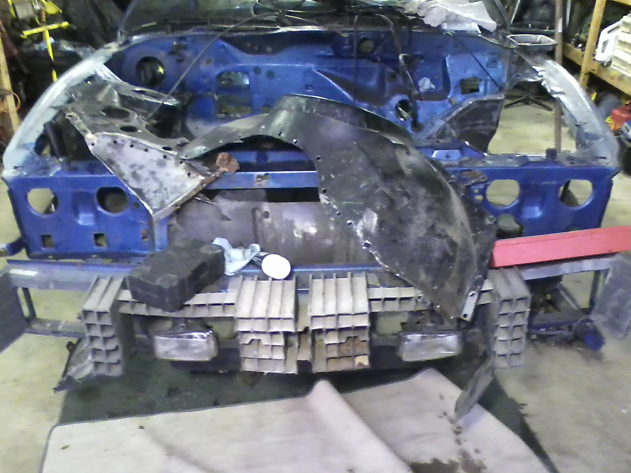

Hi everyone, I wanted to take some pictures and start my own thread. I'm doing a major restore on a classic. Never been this deep into a car before but I think I can handle it. Dropping in a 350 TPI speed density setup as soon as I get the rust handled. Here's a few pics.
Attached Thumbnails Build thread, saving an Iroc-stripped-down-iroc.jpg   Build thread, saving an Iroc-iroc-drivers-floor.jpg   Build thread, saving an Iroc-iroc-rear-fender-well.jpg

Already fixed a bad firewall before I took any pictures. Also heres a couple of my donor 91 RS.
Attached Thumbnails Build thread, saving an Iroc-firewall-repair.jpg   Build thread, saving an Iroc-91rsdonor.jpg   Build thread, saving an Iroc-91rsdonor-floor.jpg

Wow , that cancer was bad making some good progress

Wow, seeing rust like that makes me like my southern cars so much better. Good job on saving her.

Got the drivers side inner fender and small section of drivers side firewall hacked out and ready to weld in. (pic1)
Pic 2 and three are of the poor sacrificial lamb as I get closer to getting the floorboards completely out. I'm drilling out every spotweld as I go and dismantling it piece by piece. When I'm done with the donor RS it will definately fit in the back of my shortbed pickup

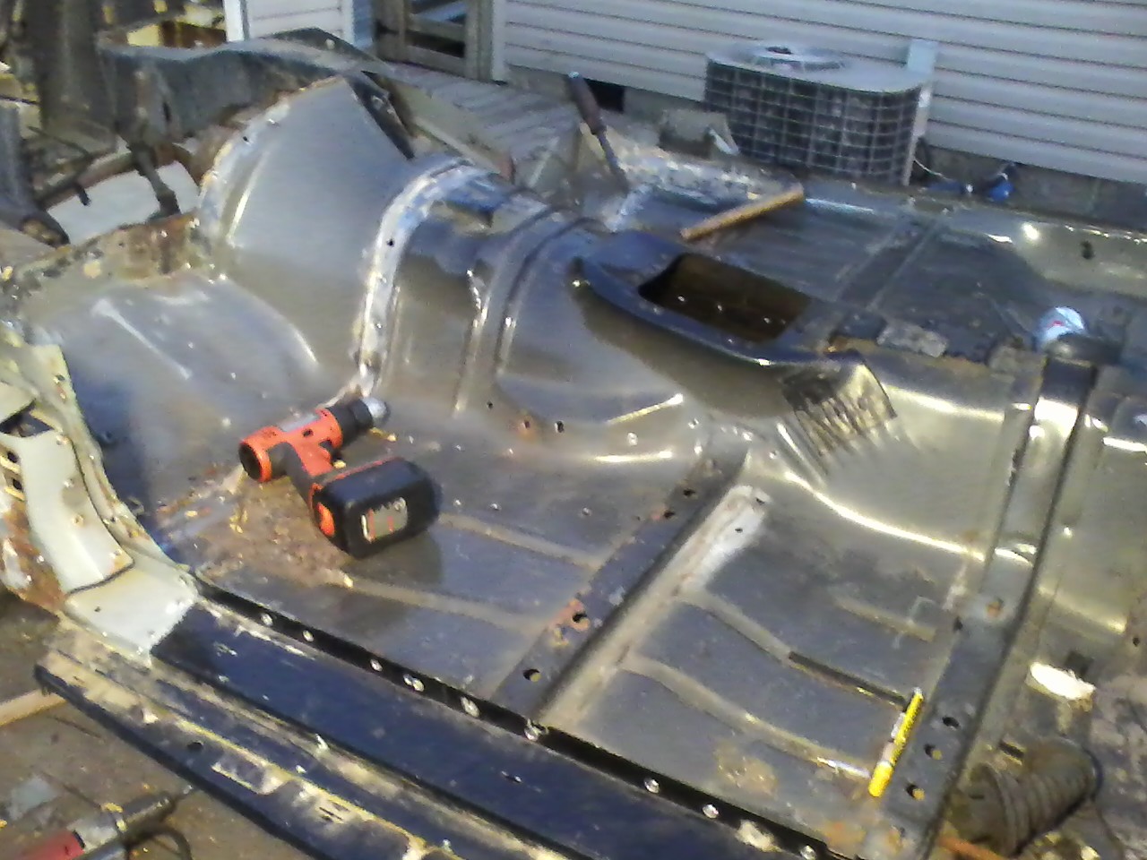

Size:  42 BytesFinally got the complete floorboard out of the donor RS. The pile of rubble pictured is almost ready for the scapyard. Been focusing on donor car because of rain/rust. Now I can get to work on the keeper.

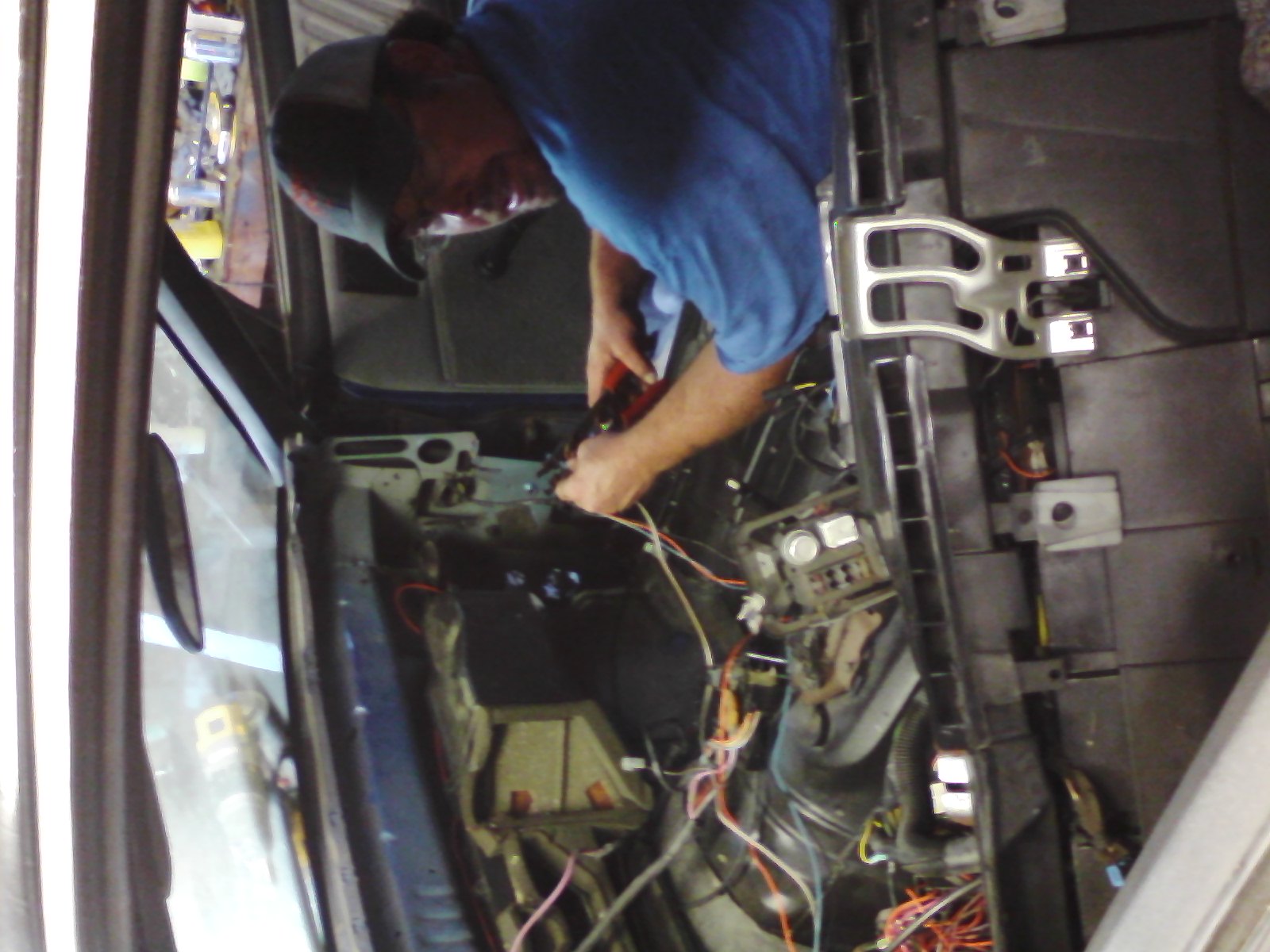

Think I figured it out. All pics I took with fancy camera are to big ( 3 megabytes or bigger).
Here is one of me wiring the dashboard in taken with son's phone. It should work.
Originally Posted by gbettner
Down loading pics is not going good. Trying again......

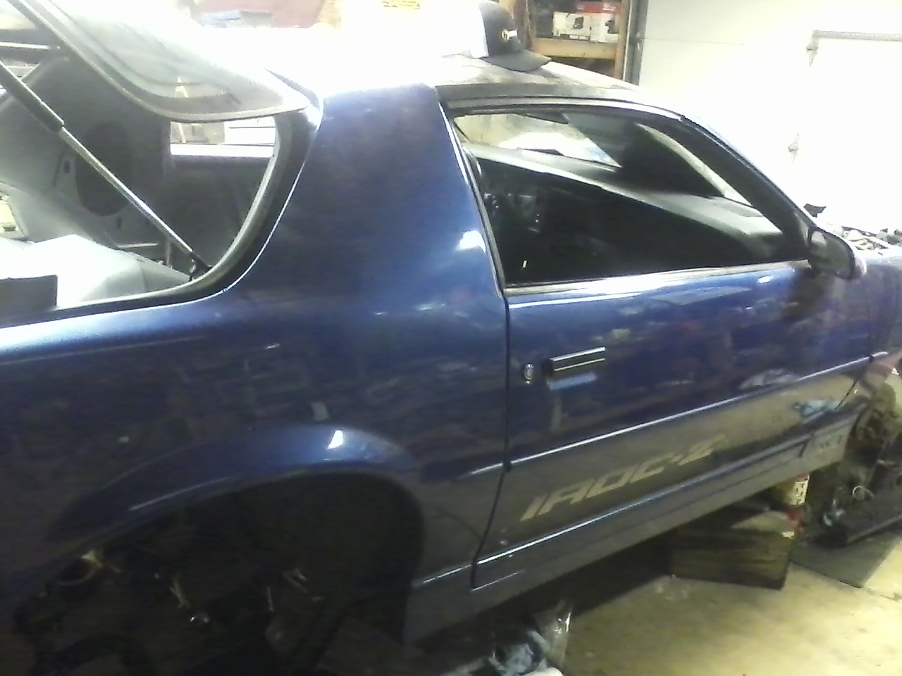

Got most of the interior in, ECM and repinned harness done, doors on, fenders on, engine bay ready for an engine, got the 350 tuned port prepped to drop in tonight with F body fuel rail, new fuel rail crossover tube O-rings, new 22# injectors from south bay injectors, new crossover tube gaskets and valve cover gaskets.
I'll swap tailshafts tomorrow and plan on dropping in this weekend.
Can't put the rearend in until I figure out if the fuel pump I installed from the 92 RS donor car is high pressure or not.
harness quote=Topspeed;5582752]Good luck with the build...Looking good so far. I was in the same spot you are in now two years ago and just finished my build two weeks ago.[/quote]
Build thread, saving an Iroc-ground-effects-going-back
Got a little too exited and dropped engine and tranny in tonight! Tight fit but it's resting in it's new home. I got a few crappy phone pictures of engine dropped in, dashboard back in, and ground effects going back on.

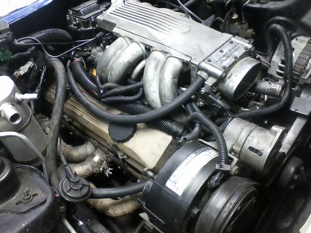

Thanks for the tip on water pump. I switched it out.
Now, thanks to alot of help from TP, I have dizzy and coil wired up, injectors wired in, headers bolted on, and I think all the vaccum routing and sensors I need hooked up are done. Just got to do a little searching and figure out if MAT is needed , what it looks like and where it's at if needed.
Tomorrow will be final wiring hook ups, spark plugs and wires, and motor mount bolts.
Here's a couple pics of engine bay progress.
Looking good, wrong water pump if your going to use the serpentine belt.
Attached Thumbnails Build thread, saving an Iroc-engine-progress-1.jpg   Build thread, saving an Iroc-engine-progress-2.jpg

Well it's far from perfect and still has some bugs to work out but here's a couple pics of a reborn 89 Iroc with fresh floors, firewall, shock towers and wheel wells, and a complete transplanted 350 TPI motor and vette tranny.
I drove it just a little bit and friggin LOVE it!
Originally Posted by 6SIX6
Good to see you got it running and done
